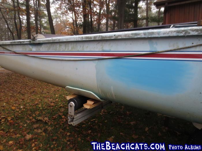

  • Sorry, forgot the photo link. I used my Trailex trailer, that was setup for the Nacras to retrieve an H18 that I restored. This is what I cobbled together for the rounded Hobie hulls.
    I used SS machine screws with countersunk heads, so nothing sticks up from the PVC pipe to damage the hulls.

  • Getting a little off topic here, but the only issue I’ve found with that cradle arrangement is that the potential exists for the cradle to rotate its way around the hull and pop out. You can put a little stopper on each side of the cradle that will contact the trailer roller and keep the cradle centered on the roller. Or, in my case, I just tied a short length of line to connect the cradle to the trailer so if it does pop out, it doesn’t get lost. I also don’t have to worry about having a storage place for the cradles when they’re removed- I just take them off and let them hang by their cords.

  • QuoteGetting a little off topic here, but the only issue I’ve found with that cradle arrangement is that the potential exists for the cradle to rotate its way around the hull and pop out.
    OR worse have the cradle rotate just as you are putting the boat on it and the bolts scar or pop your hull
    I put a block of wood with holes drilled out for the bolts and rubber cemented this on the bottom of the cradle
  • The cradles we are talking about are removable and are placed over the trailer rollers, not present when putting the boat on the trailer. You use the standard trailer rollers to get the boat on the trailer. Then once the boat’s on the trailer, you lift the hull and slip the cradle between the roller and hull. This gives you the best of both worlds- rollers which make it easy to get the boat on and cradles to protect the hulls from point loads.

    The bolt heads are the countersunk,(45* angle heads). After drilling the holes in the PVC, put a countersink gizmo in your drill, & cut an “inverted pyramid” into the PVC. The Bolt head sits just below the surface of the PVC, & cannot contact anything.
    The other end of the Bolt is slightly shorter than the thickness of the 2x2. A small hole accommodates the bolt shank, a larger one appx 3/4” deep, accepts the nut, keeping it below the surface. There is nothing that can score the hull.
