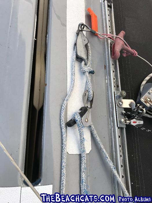

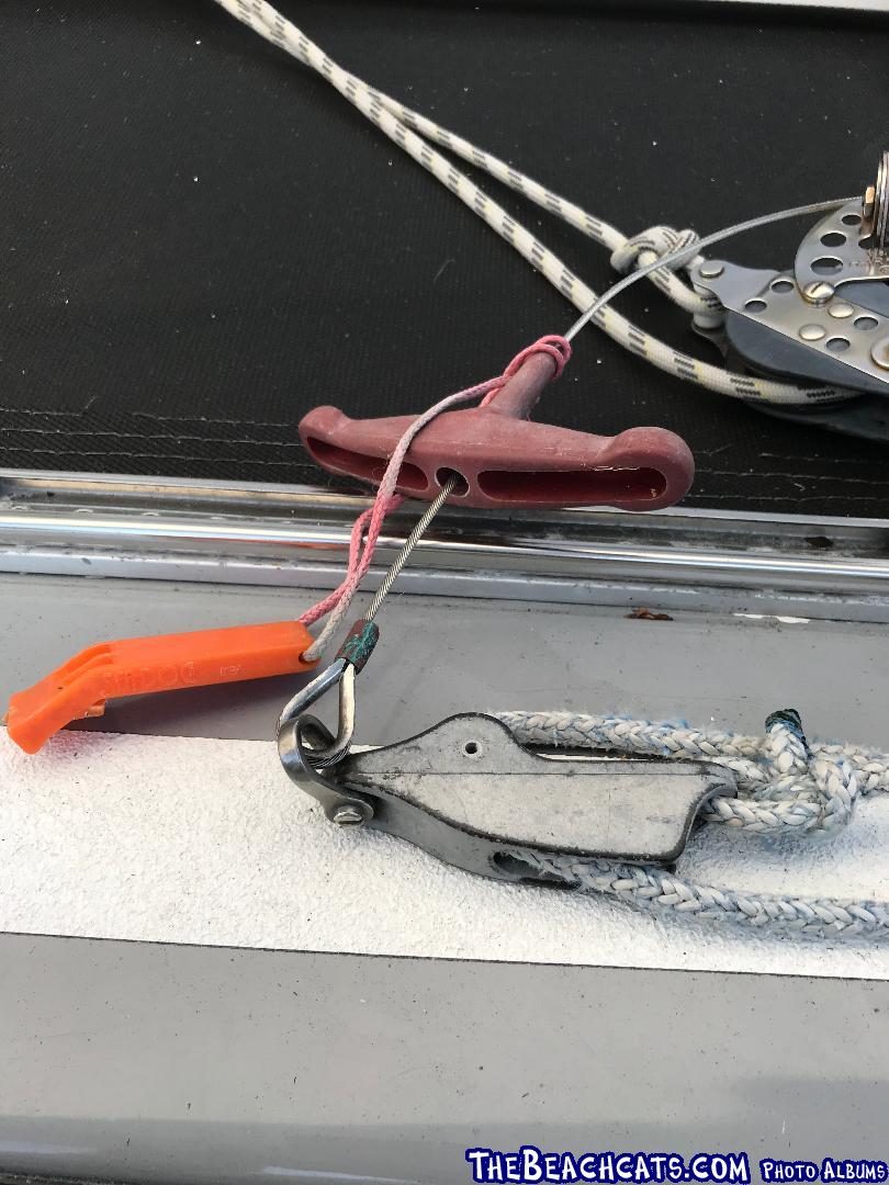

  • https://www.thebeachcats.com/gallery2/main.php?g2_view=core.DownloadItem&g2_itemId=130495&g2_serialNumber=3
    https://www.thebeachcats.com/gallery2/main.php?g2_view=core.DownloadItem&g2_itemId=130493&g2_serialNumber=4
  • I believe the cleat is a 3/16" hole. If so, I would use a 3/16" shackle with the allen flat head, instead of the screw pin with the finger tab. Simular to https://www.westmarine.com/buy/wichard--self-locking-stainless-steel-allen-head-shackles--P012420337?recordNum=85
    I have found many times the adjustment line catches on the screw pin with the finger tab. The flat head screw pin tens to stay more flush. They are a bit more expensive, but may cause less problems down the road.

  • Looking at Andrew's photo, it appears that the trapeze line is connected at the bottom right corner with a plastic hook. Unless I'm losing context not seeing it on the boat, it seems that if that hook breaks, the whole trapeze system comes apart. Am I right about that?
    Dana, Holly, Emma & Hannah
    LJ/Stu's Dart 18 (Sold! :( )
  • No, that’s the “return” bungee. If that breaks the trap is still going to hold, but it will flop around freely when not hooked up.

  • Gotcha. On our boat, that hook gets connected to the bottom of the dogbone, except we have the weird oval like one in the picture.

  • Here's what I went with: https://www.amazon.com/gp/product/B071Y57Y8H
    It is a 3/16 D-shackle instead of a bow shackle (not really a multidirectional load that would require a bow shackle)... the 'throat' of the shackle clears just over 7/16" (11mm), so it works for the clamcleats. That's 550lbs working load and 4X that for breaking load. Both the pin and the shackle itself are formed from 3/16-diameter stock.
