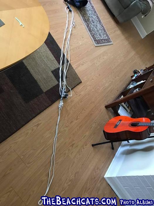

    There is about 20' of line for the 4:1 blocks - that gives you 5' of area to work with (sea-level to shoulder height so you can push it out with your back)
    The top becket on the blocks has about 6' of line that is meant to be attached to the righting line or tied around a hull - u can modify it with a carabiner, s hook or whatever you want

  • I got the complete system just in time for a stationary front to setup shop over us. No winds and hot, humid conditions. I guess I'll hang in the pool for a day or two. The system seems pretty nice and straight-forward, but I don't see an easy place to attach a line to the bottom.
  • An iron-on patch over a rope with a stopknot would be the easiest way. Would be nice to also have a floating rope, so long as it doesn't defeat your filling the bag.
