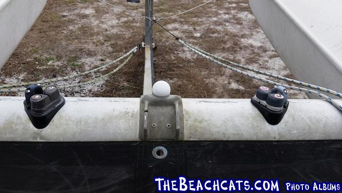

  • The mast base on most beachcats is riveted to the mast....
    https://www.thebeachcats.com/gallery2/main.php?g2_view=core.DownloadItem&g2_itemId=107991&g2_serialNumber=4
    just as mast step (cradle) is riveted to front crossbeam...
    https://www.thebeachcats.com/gallery2/main.php?g2_view=core.DownloadItem&g2_itemId=112867&g2_serialNumber=4
    Over time, the elements and electrolysis (the chemical reaction between 2 dissimilar elements/metals) erode the connection and requires attention as in 1st pic above. Please do NOT use any type of glue, rather, look through 'Catamaran Technical Tips' under the Photo Albums tab up top for ways to repair your current problem, tons of good advice.
