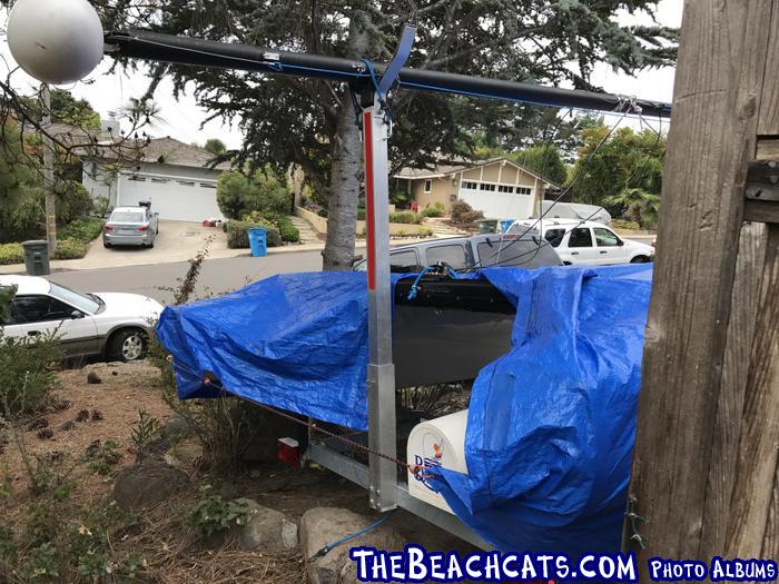

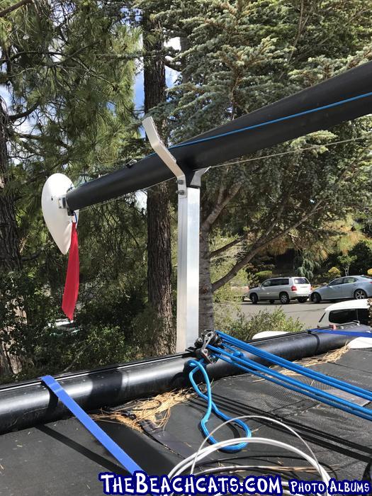

  • I've got my mast stepping pretty well dialed in. I made a mast support for the rear of the trailer and that aids me in the stepping by starting the mast higher than the tramp. I slide the mast back on the rear support until I can get the base pinned. A rope from the hounds goes to my winch rope that is on the front trailer mast support. The trap wires attach to the front beam for lateral swing. I then crank the winch and up goes the mast, attach the bridal and I'm done. Takes 5 min or less. I usually get rigging hung up someplace during stepping, once I get that sorted into a process I'll be set. The mast auto rotates out of the initial 90 position. No spreaders to worry about.
    To lower the mast I reverse the stepping process, but I have to rotate the mast 90, so I attach a rope (the bow line) to a pad eye on the bottom of the mast and pull, turning the mast 90, while lowering. It takes both of my hands to lower it.
    I have video of lowering, but no video of raising the mast. I'll see if I can post it to YouTube and film the raising process.
    Edited by tradisrad on Sep 03, 2017 - 01:04 PM.
  • Tradisrad, could u post a pic of your mast support?
    2016 Hobie Getaway
    1978 Nacra 5.2
    1978 Hobie 16 (back in the day)

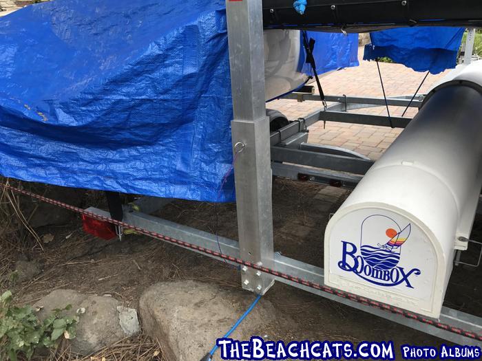

  • The mast support is made of two aluminum extrusions. The upper part is, obviously, removable and slips into the lower section and is pinned in place. The lower section is bolted to the trailer.
    Overall it's 52" from the rear beam of the trailer to the bow stop the mast rests on. From the rear cross bar to the mast is about 30".
    I now need to find a place to store the mast support on the trailer while the boat is on the water. Currently I stick it in the car and I fear that I will eventually damage the interior. I may get another section of extrusion and bolt that to the trailer tongue or frame and slip the support into that... I still need to think about it.
