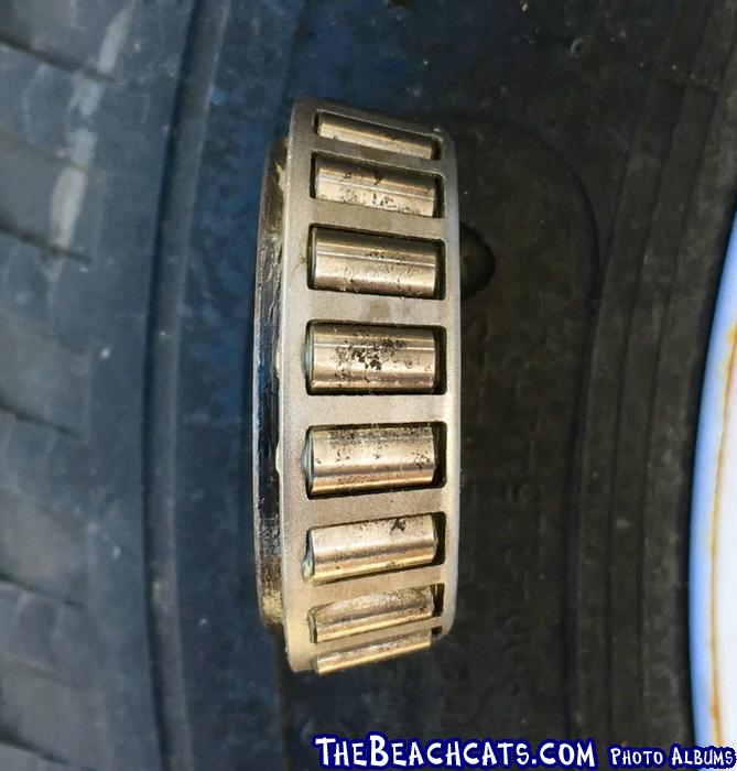

  • In preparation for the new season I disassembled and inspected my trailer bearings. Unfortunately, after only one season (new and fully packed with premium marine grease last year) here is what I found (bad dog!!!). I found entire replacement hubs with bearings and seals on etrailer for $ 17.49:
    https://www.etrailer.com/Trailer-Hubs-and-Drums/etrailer/AKIHUB-440-2-1K.html
    The hubs were delivered in three days and installed without argument = VERY CHEAP insurance!
    https://www.thebeachcats.com/gallery2/main.php?g2_view=core.DownloadItem&g2_itemId=127472&g2_serialNumber=4

    The premature failure I experienced was a result of the seal leaking not lack of grease.
  • Last fall I inspected my bearings and found them in the same trashed condition as yours - after installing not-cheap Timken bearings just two seasons ago.
    I found a Westernprime complete kit with bearings & seals for $20 on Amazon. They're chinese (IIRC) but I decided for that amount I would just replace them once a season. Also using marine grease and the Reese "bearing buddies" which are very nice for $10 shipped on Amazon.
