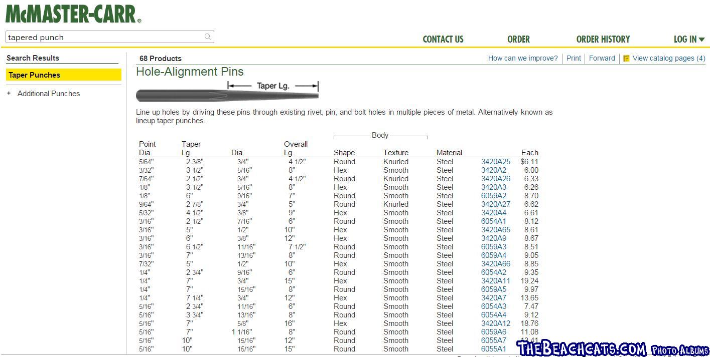

Here is a variant of the tool some folks (including me) use.
You can make tapered wooden dowels which work well, but these work just fine too. I don't remember which PN I use, but depending on the diameter of the lacing line you use select one that has the mid point of the taper matching the space between your line and the ID of the grommet so as to have sufficient taper left to compress and lock the line. You will need at least two pins, I use three.
