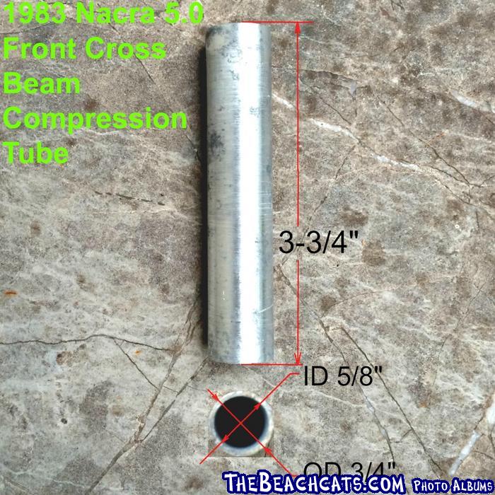

  • Ok, there's been a lot of talk about dolphin strikers lately, and I KNOW my DS rod/mast step bolt is bent in two directions. I don't think it's necessarily weaker but I'm gonna change it anyway. However, I'm quite concerned that it's gonna be seized to the sleeve. Here's what I need to know:
    Does the sleeve completely pass through the main beam or does it fit inside? Another way of asking is the hole in the beam equal to the inner diameter or the outer diameter of the sleeve?
    Thanks, I just want to know what to expect when I go in.

  • The sleeve (called a compression tube) fits inside the crossbar. The sleeve ID is the same as the diameter of the hole in the crossbar that the DS post goes through.
    https://www.thebeachcats.com/gallery2/main.php?g2_view=core.DownloadItem&g2_itemId=120079&g2_serialNumber=4
    Hope this helps.

  • Upon further review....apparently as stated earlier in this thread (thank you leebow) the I.d. of the compression tube is 5/8 and this jibes with Murrays info. The rod is 9/16 so with that much slop I can't see how it could be stuck too bad.
