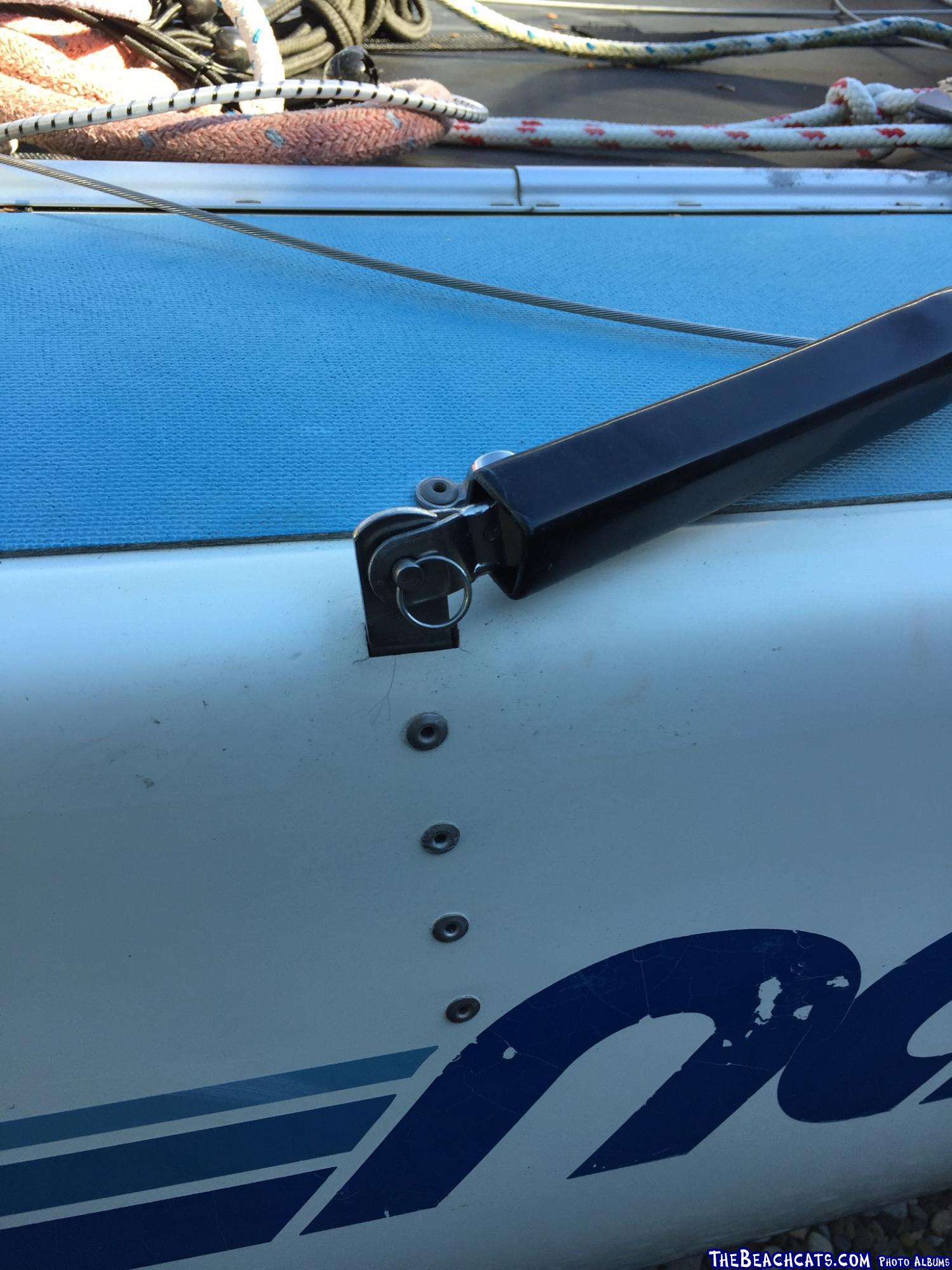

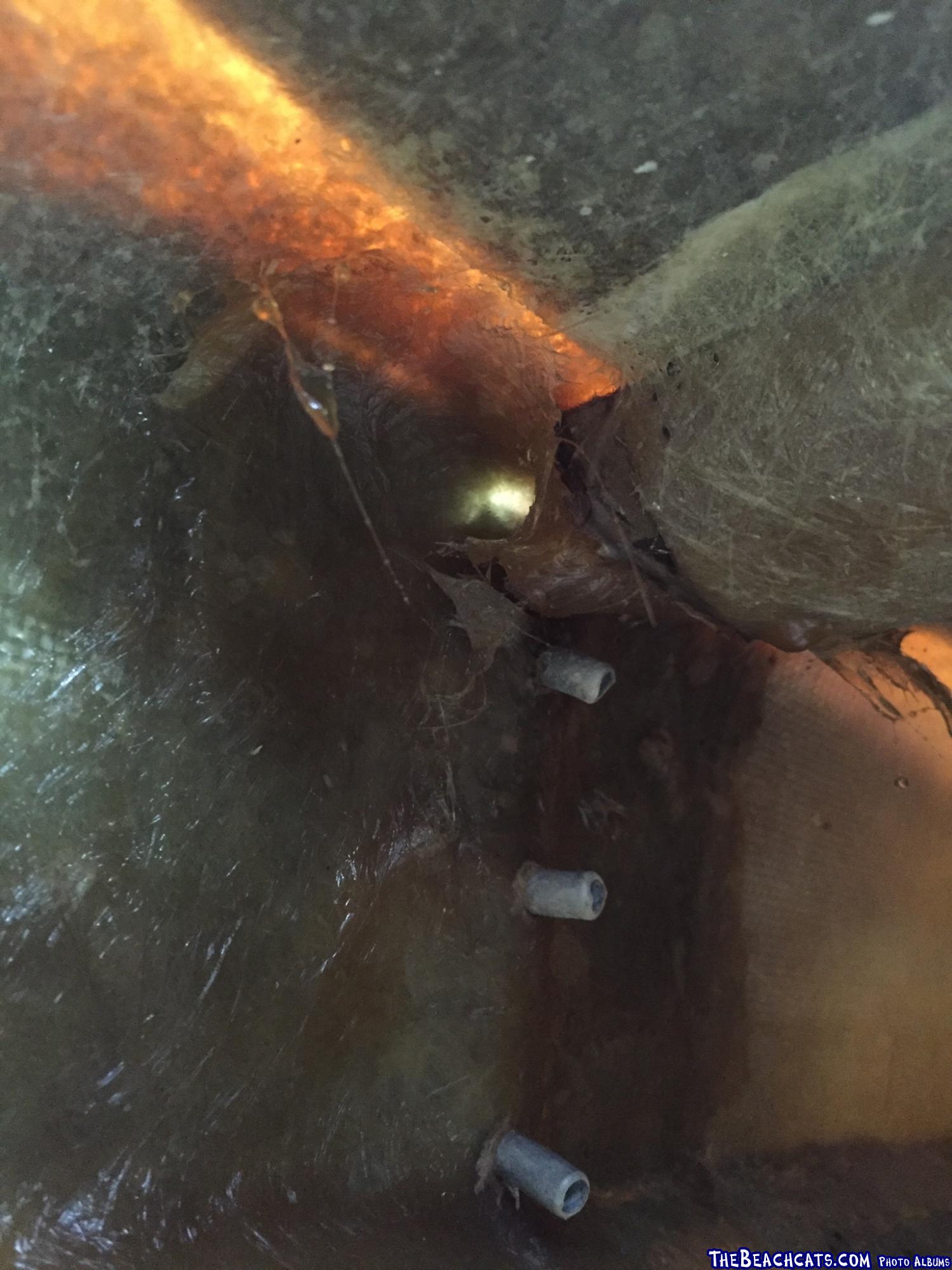

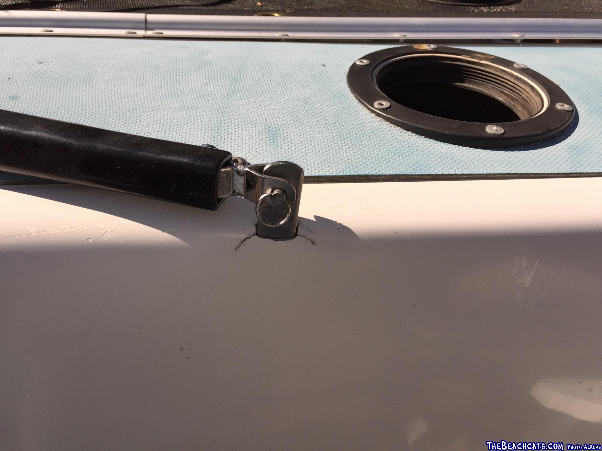

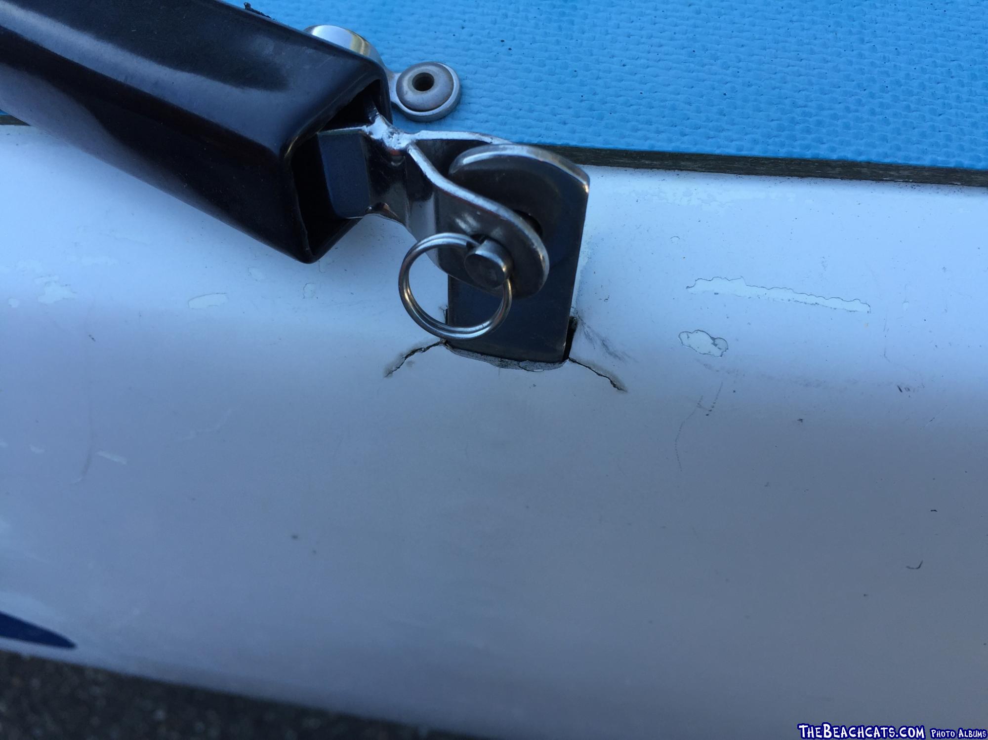

    Issue 1: There are cracks where the shroud chainplates enter the hulls. On the starboard side, there was clearly a fiberglass repair done, outside and probably inside. There is only one inspection port installed, on the starboard hull just inside of the shroud chainplate, likely to facilitate repair. About a 2-foot square section on the side of hull was refinished, though the added gelcoat (or maybe hardened marine paint) is flaking in places. On the inside it looks like a lot of epoxy was added; can’t really tell how much glass fabric was used. On the port hull a series of rivets were added on the outside of the hull to reinforce the port shroud chainplate, presumably to avoid a repeat of whatever happened on the other hull; there is no inspection ports on the port hull.
    http://www.thebeachcats.com/gallery2/main.php?g2_view=core.DownloadItem&g2_itemId=125392&g2_serialNumber=3
    http://www.thebeachcats.com/gallery2/main.php?g2_view=core.DownloadItem&g2_itemId=125393&g2_serialNumber=3
    http://www.thebeachcats.com/gallery2/main.php?g2_view=core.DownloadItem&g2_itemId=125394&g2_serialNumber=3
    http://www.thebeachcats.com/gallery2/main.php?g2_view=core.DownloadItem&g2_itemId=125395&g2_serialNumber=3
    http://www.thebeachcats.com/gallery2/main.php?g2_view=core.DownloadItem&g2_itemId=125396&g2_serialNumber=3

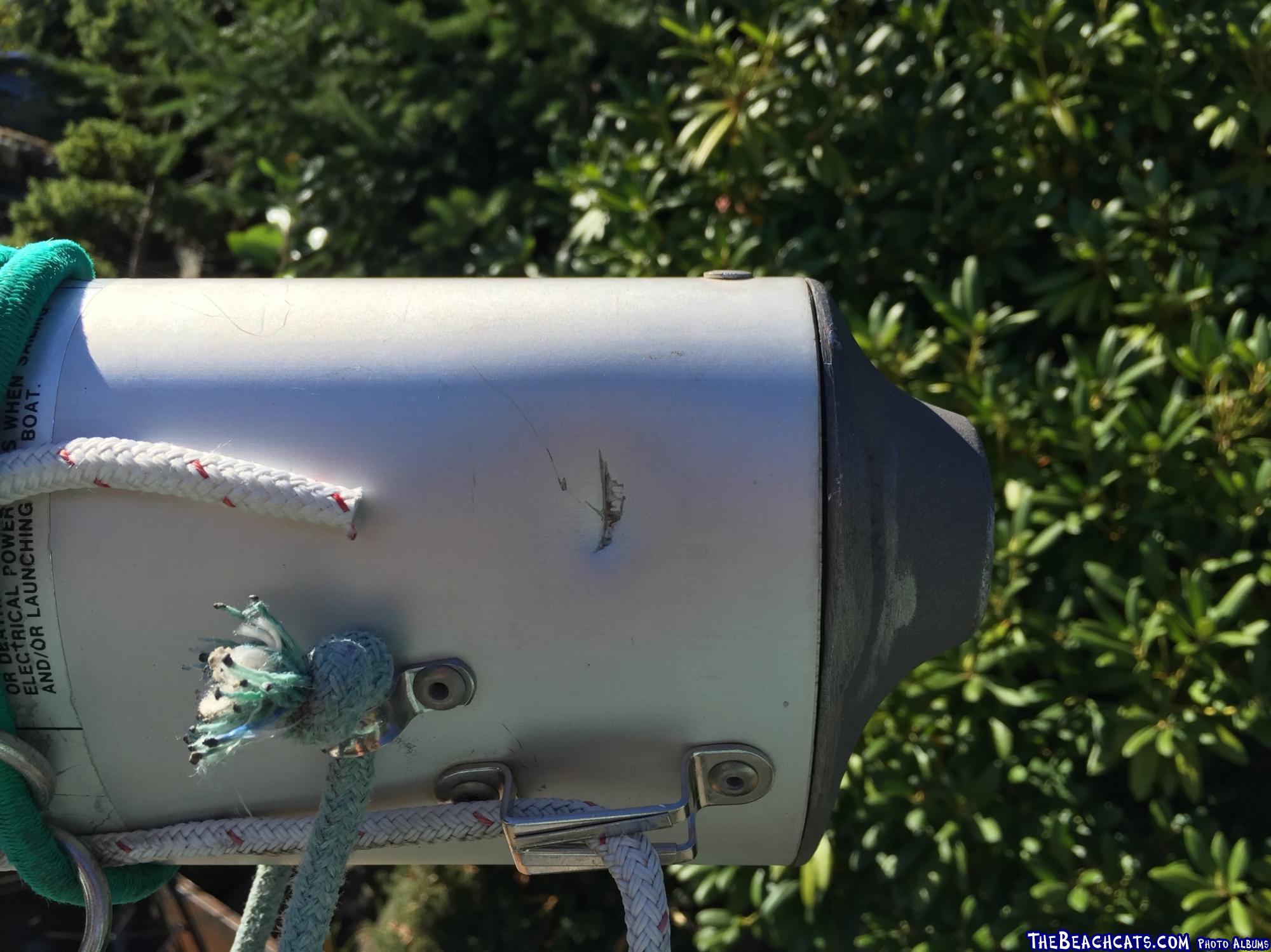

    Issue 2: There is a dent in mast just above the mast foot, slightly larger than a thumb print. It looks like it is dented just above the internal flange of the mast foot casting. Otherwise, the mast looks straight and in good shape aside from some scratches and nicks.

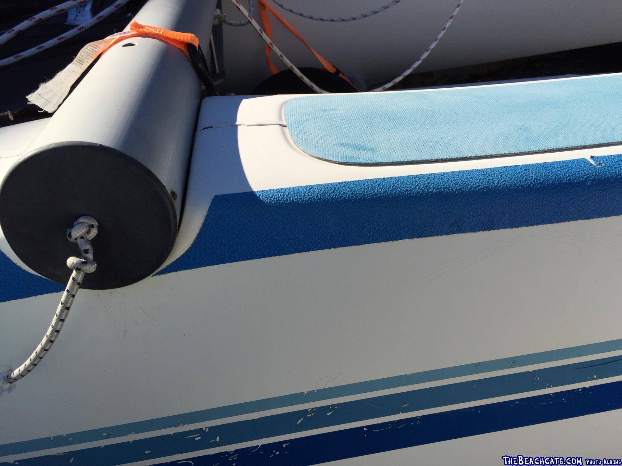

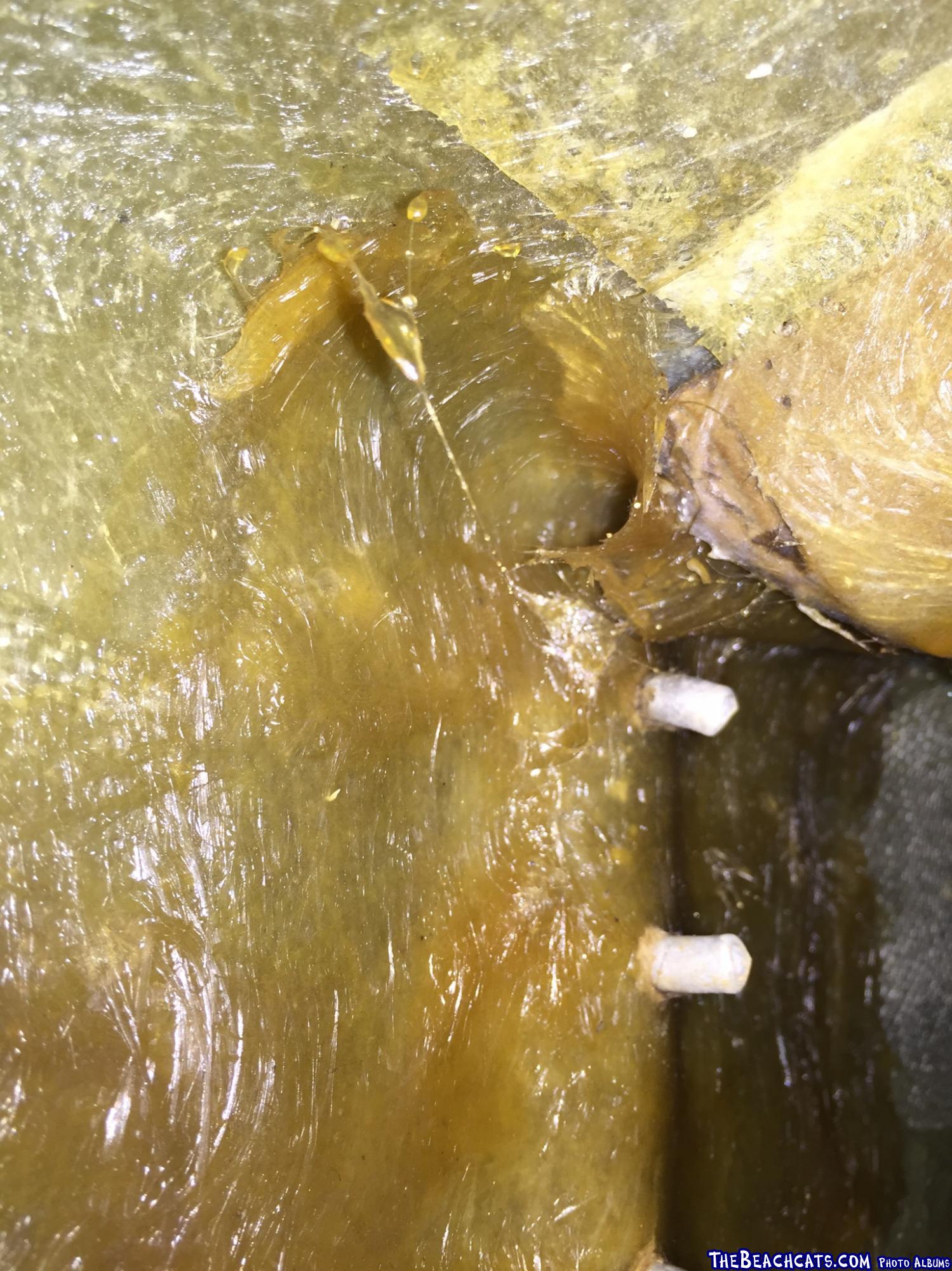

    Issue 3: When I press down on the top of the hull just forward and aft of the forward beam, the surface flexes noticeably. This happens on both hulls. The rim of the inspection port on the starboard side is cracked in multiple places around the rivets, likely from flexing. I know this model is fiberglass, rather than foam core sandwich, so I expected flexing in the sides of the hull, but thought the tops of the hulls should be stiffer. Pretty much in all the wider non-skid areas on top of the hulls, there is flex; the more narrow areas near the bows are rigid.

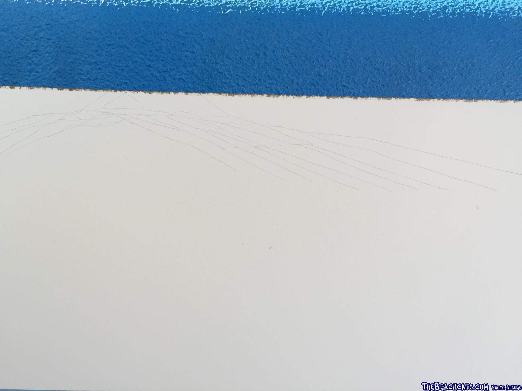

    Issue 4: There is crazing in a foot-sized area of the gel coat on the outside surface of the starboard hull, slightly forward of the forward beam, near the top of the hull’s side.
    http://www.thebeachcats.com/gallery2/main.php?g2_view=core.DownloadItem&g2_itemId=125401&g2_serialNumber=3
    http://www.thebeachcats.com/gallery2/main.php?g2_view=core.DownloadItem&g2_itemId=125402&g2_serialNumber=3

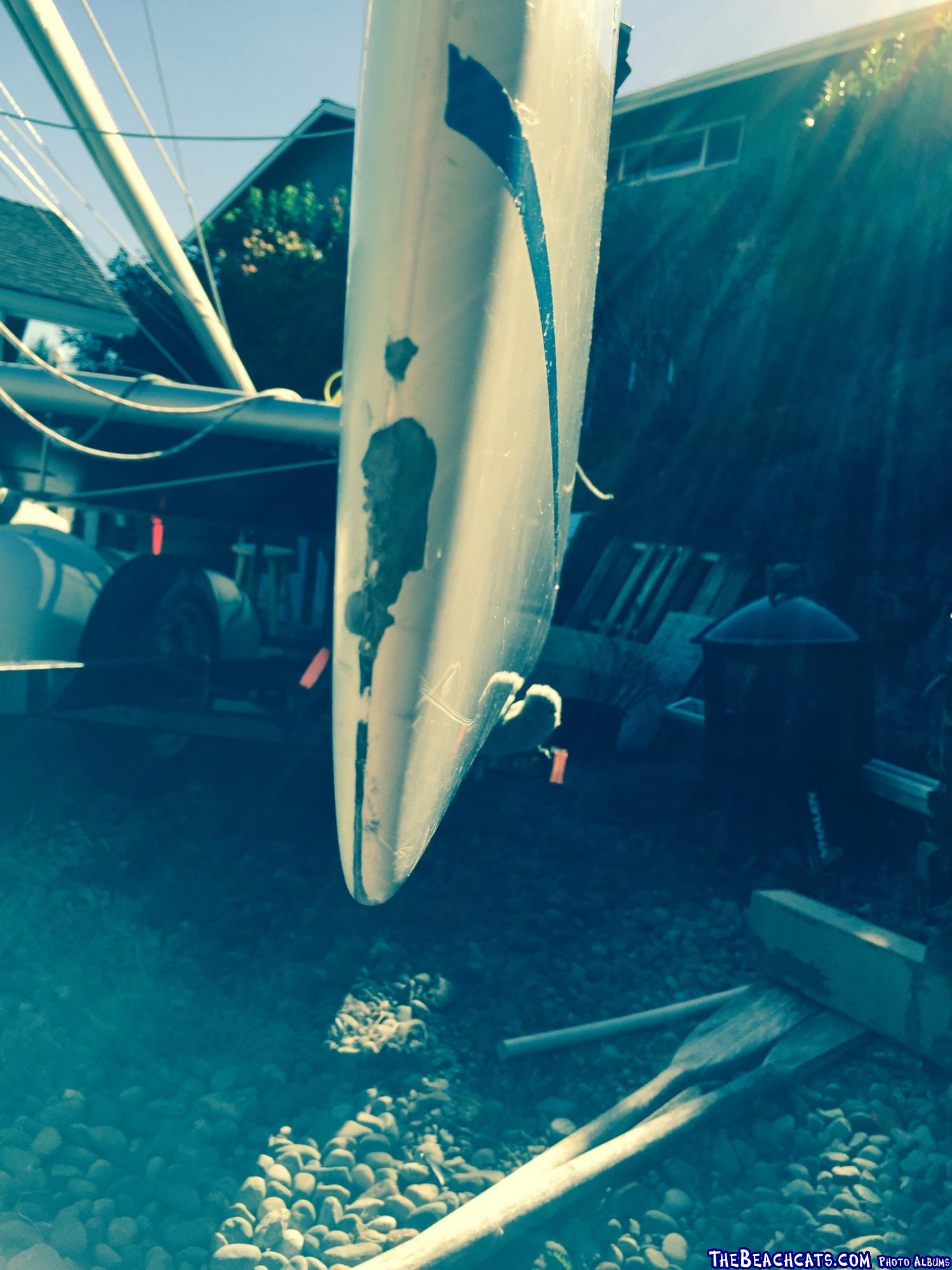

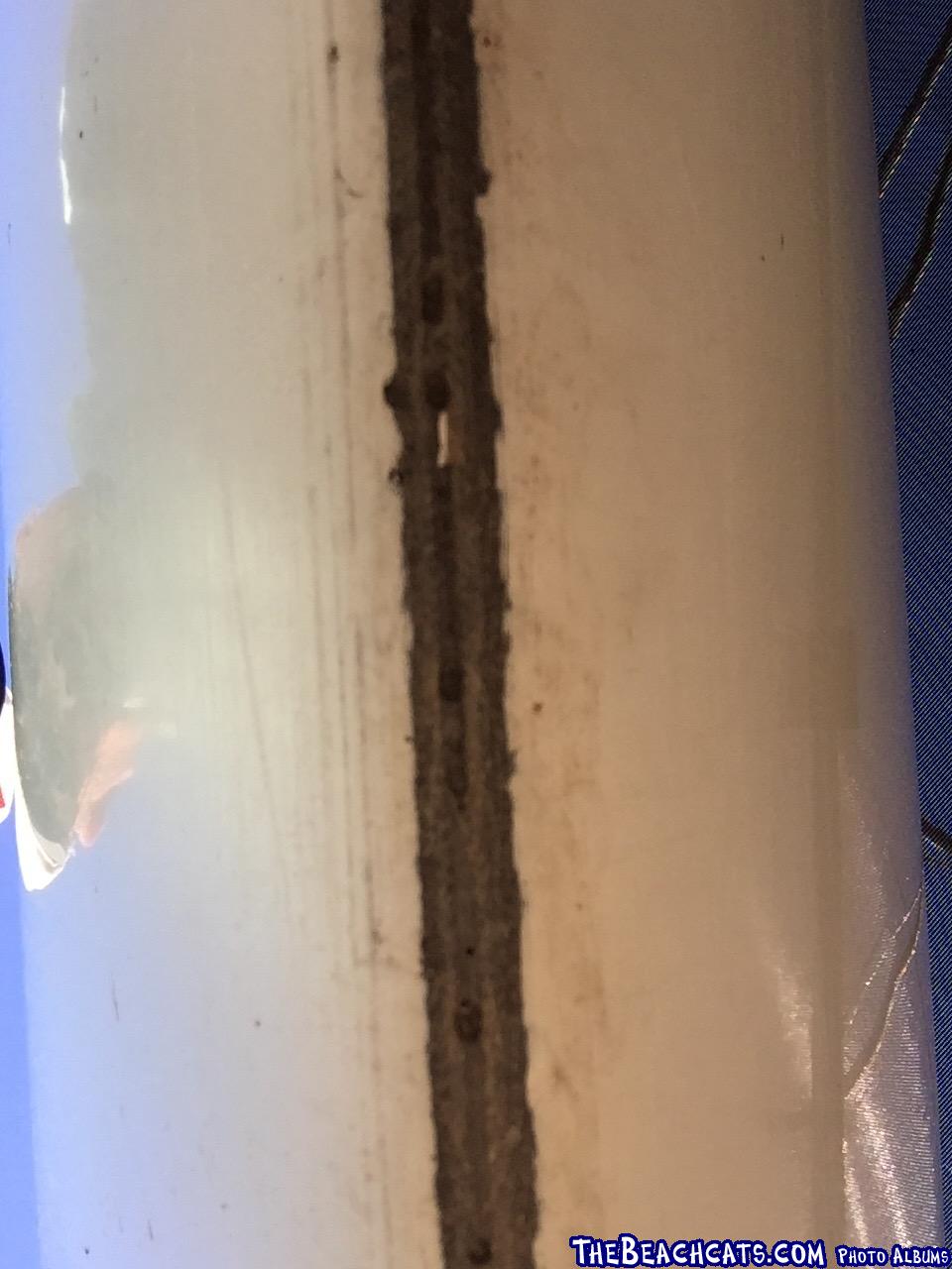

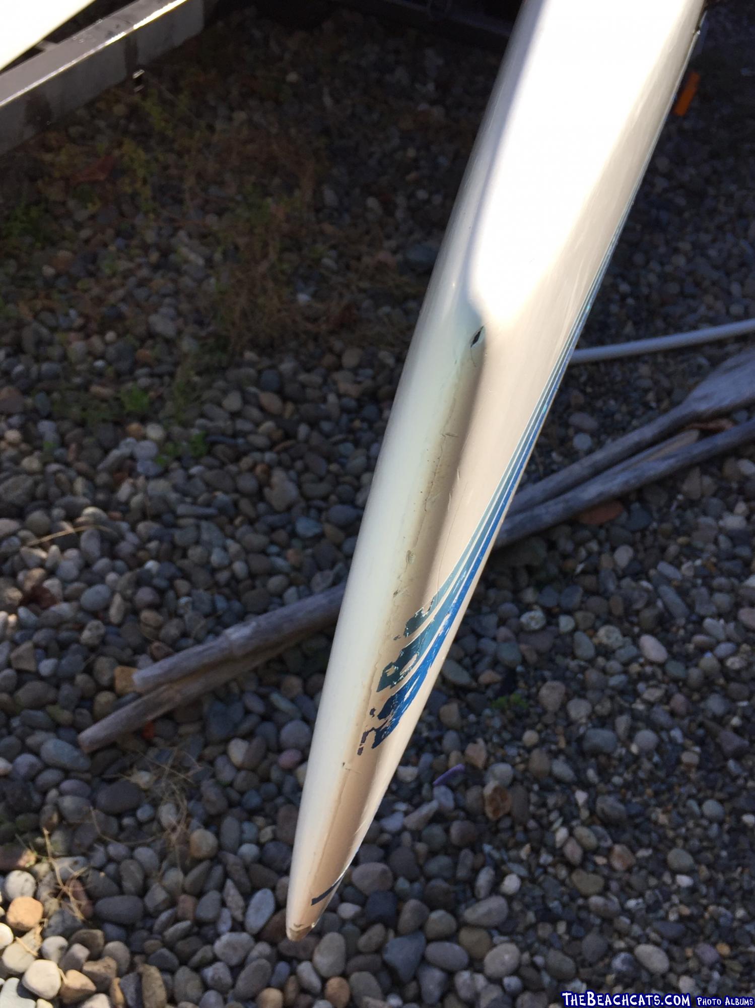

    Issue 5: There is wear along the entire length of both keels, and some small cracks and chips on the vertical edge of both bows. This isn’t too surprising and doesn’t look serious. But in some aft areas of the keel there are gouges/voids in what appears to be the seam where the two halves of the hull are joined. Sorry, but the only picture I got of this isn’t in focus. It seems like I could fill these voids with Marine Tex, and perhaps use Marine Tex along the entire keel to minimize further wear. There are also some gaps showing in the seam between both hulls on top, between the non-skid surfaces. It looks like whatever Nacra used to cover the seams (gel coat?) has gotten brittle. I see a few short (3-6”) cracks in places on the non-skid, but no lengthy longitudinal cracks which would indicate separation of the hull halves.
    http://www.thebeachcats.com/gallery2/main.php?g2_view=core.DownloadItem&g2_itemId=125397&g2_serialNumber=3
    http://www.thebeachcats.com/gallery2/main.php?g2_view=core.DownloadItem&g2_itemId=125398&g2_serialNumber=3
    http://www.thebeachcats.com/gallery2/main.php?g2_view=core.DownloadItem&g2_itemId=125399&g2_serialNumber=3
    http://www.thebeachcats.com/gallery2/main.php?g2_view=core.DownloadItem&g2_itemId=125400&g2_serialNumber=3

    1) Cracks and repair of shroud chainplates
    This is normal, especially cracking of gel coat near the top of the fixture. They do fill and repair, and probably don't mean a structural failure, but rather normal flex in an area that gets a lot of stress.
    2) Mast dent
    This is not in an important structural part of the mast. It looks like this dent near the step is the result of a drop or impact, and should not compromise mast integrity.
    3) Soft areas on top of hulls
    The NACRA 5.0, like mine, has a no-skid cover put over openings below. The area can be reinforced, or even replaced. I tend to tread lightly on the spots that seem to give. I assume this does not affect the hold-down straps, which you should remove, add anti-seize and tighten to a light torque.
    4) Crazing in gel coat
    Normal wear and tear. I see it on every boat not reconditioned.
    5) Gouging and wear on keel
    The boat has been beached many times causing wear. This will require re-glassing, fairing and finishing. A pain in the but for sure, but repairable.

    1. If it was repaired it looks good. The rivets are supposed to be there. A little cracking where the chainplate exits is normal make sure you seal that up its a good place for leaks to happen.
    2. Not even worth looking at.
    3. This is a bit of a concern to me. Could be a problem if its too soft but it is a fiberglass only construction so some oilcanning is expected. If there is a port to access you can reinforce from below. Taking the decks off is tricky, especially the rear one, but that is a possiblity to reinforce.
    4. Normal nothing to worry about.
    5. That boat needs a bottom job bad. The 5,0 and 5.7 attract wear on the skeg hulls and often need some reinforcement. Thats been left too long for just marine tex. I would flip the hulls, grind and clean the keels, wet out with a layer of west system epoxy, then 2 layers of glass tape 2" and 3" in width (just buy it like that). A layer of thickened epoxy then marine tex. That will run you a couple of hundred bucks in materials and about 2-3 days in time, mostly waiting for epoxy to set up.

    The repair job they did on that chain plate is the sh*^ts, makes me want to puke. There appears to be no cloth, only resin, that means no strength.
    I would grind it out,(if you remove the hatch casing you can put a 4"angle grinder in), & replace with 4-6 layers of wetted 6 oz cloth. You should use just enough resin to wet the cloth, & it should be clearly visible through the resin.
    I'm not sure why there are no rivets in one chain plate, perhaps they snapped it & replaced it with a homade fitting?
    Tom & Daves advice is spot on, but I disagree with #3.
    The decks on these boats sit on a frame, see my album here,
    http://www.thebeachcats.c…pictures?g2_itemId=82844
    If the soft spot is in the deck material itself, you could remove the deck & fix. There are a couple albums here showing that. If I stand on my decks, I can see a bit of flex in areas between the frame. If by "soft" you can flex it by hand, you have a serious problem.
    If the soft is in the white fibreglass just ahead/aft of the beam, run away...there should be zero flex there, you are in danger of pulling the strap fittings out of the hull. IF you could show him the damage, & get the boat for 1/2 price, & IF you want a major repair job, you could remove the deck, grind away the damage and repair properly. There is an album here showing a single strap fitting repaired, (on a 5.2), but same construction here.
    The bottoms are badly neglected, but a technically easy fix. Flip upside down, grind out loose crap, fill & fair with thickened epoxy, then add 2 layers of fibreglass tape/epoxy.
    New wires will run you appx $400, plus another few hundred to fix the damage, plus time. It's doable, but it's not a $1500 boat.

    The skeg are solid, especially at the skeg itself, with less as you go forward, or along the upward sweep at the stern. Use the edge of a thin wheel to grind any loose stuff out, fill with epoxy thickened with microfibres, then glass over.

    If you decide to proceed,(personally I wouldn't, unless I got if for $700), I would take it apart to fix. If it were only the bottom job, you could flip it. To do that chain plate, & soft decks/beam fittings, it is way easier if you could an place the hulls upside down, or on sides as needed. Gravity is your friend.

    As Mark said, the gel coat cracks are no big deal, I have quite a few in my '84 5.7.
