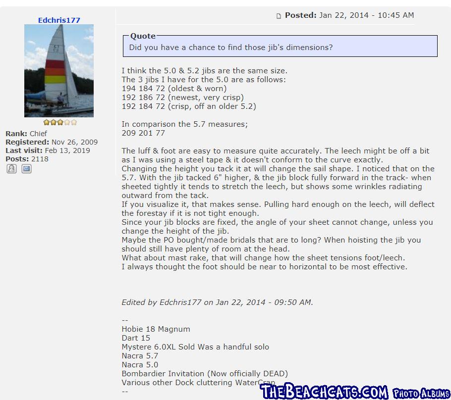

    So, did anyone ever come up with the leech, luff and foot dimensions for the 5.7 jib?
  • leeboweffect
    wolfmanCan anyone help me out with the measurements?
    Sorry Nac. I posted that somewhere, maybe a few years ago...but I can’t find it now. I’ve got the measurements somewhere, maybe on an old computer that no longer lives, but I can’t find it right now. I’ll keep looking.
  • Edchris177
    leeboweffect
    Here it is, thanks.
    https://www.thebeachcats.com/gallery2/main.php?g2_view=core.DownloadItem&g2_itemId=130850&g2_serialNumber=3
