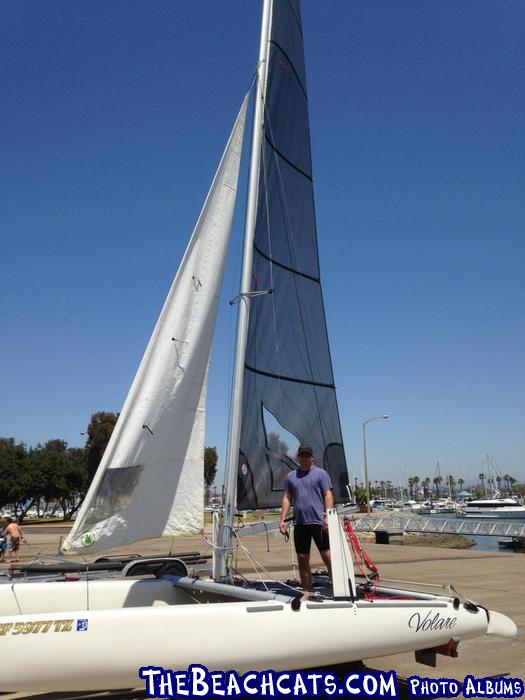

  • A pictures worth a thousand words. This is not my cat, i just cribbed the photo from one of the albums.
    You can clearly see the preventer, looks like an inverted "V".
    Click the photo to see full size
    http://www.thebeachcats.com/gallery2/main.php?g2_view=core.DownloadItem&g2_itemId=107114&g2_serialNumber=6

  • If you have a mast rotator, the jib sheet might still get snagged with the preventer rigged as shown in the picture submitted by Edchris. I solved this by running the ends of the bungee forward and outboard to the the bridle foil tangs. You can make a simple attachment using using small diameter line looped around the tang and add plastic clips to the bungee ends.
