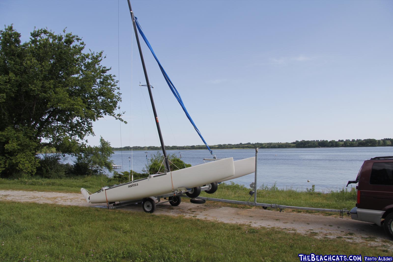

here is a photo of a jib sock i had made by a local patio awning company. the top had a hem (doubled fabric) with a grommet right near the top. into this grommet i put a carabiner. i used the jib halyard to raise the sock because the jib was attached to the swivel at the top of the forestay and did not get raised or lowered. it was always up. the hardest part was raising it past the lower batten in the furled sail.
i no longer have this boat but as i recall, i had them make the diameter about 8" so i would guess the width of the fabric was about 24". when up, i twisted the sock and tied off the bottom to keep it from flogging in the wind. i don't think a lot of water entered the top during a shower, but i'm sure some did. it never seemed to be wet or moldy when i opened the sail.
the awning company only had 10' zippers so they had to use two to make up the length of 20' that i needed. a bit of a pain but it worked.
on another boat i had, a nacra F18, i just bought a sock from Racedaytramps. i was happy with theirs and it had one continuous zipper. if i had another cat that needed a sock, i would purchase from them again.

thanks for the reply's, Nice examples and thanks for the pic. Good idea to twist it to take up slack for wind if its too loose. Also cool trailer. I like how the beach wheels ride under the hulls. The strip on the end of the jib would be the easiest, I have whirlwind sails about a year old so I'm not sure I want to mess with sewing anything on it yet. I would definitely want a one piece zipper setup if possible. I'll have to price out some material and the zipper to see if its worth not purchasing one. I have access to local sunbrella @ $21/yrd which is nice.
