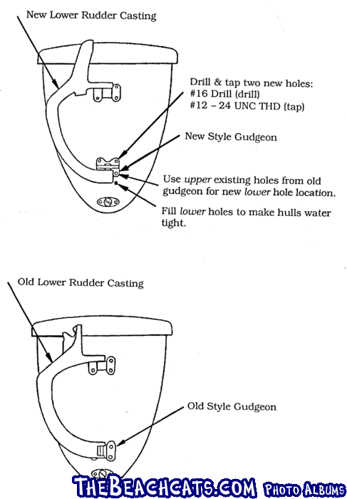

  • Yes, that looks like your hulls were upgraded from the old to the new style rudder castings.
    The rudder system was upgraded for the 1987 model year but your boat may have been an early one.
    Here are the instructions for moving the bottom gudgen up "one hole" .
    http://www.thebeachcats.c…pictures?g2_itemId=10853
    What are the last three digits of your hull number? That tells the model and manufacture year.
    http://www.thebeachcats.com/gallery2/main.php?g2_view=core.DownloadItem&g2_itemId=10855&g2_serialNumber=7
