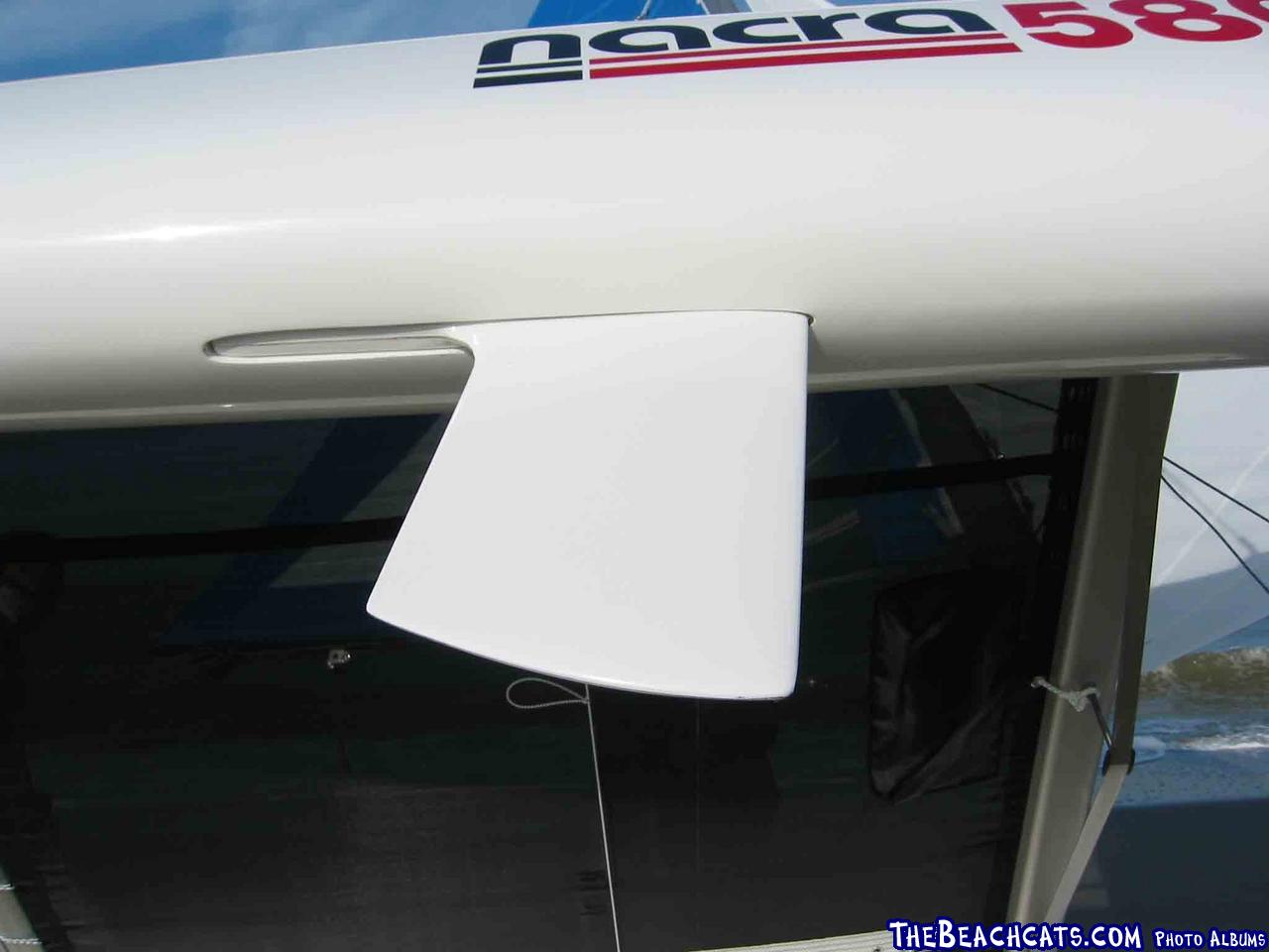

  • Does anybody know what shape hull cradle would fit these hulls? Would it be like a Hobie 18 or like a Nacra 20?

  • The 580 is a modernized 5.8. The hulls are the same, just wider beam, retractable centerboard, and the newer style rudder system.
    Did you get your hands on one?
  • http://www.thebeachcats.com/gallery2/main.php?g2_view=core.DownloadItem&g2_itemId=25477&g2_serialNumber=4
    Looks like an old 5.8 or 6.0 bottom to me.
    Hobie 20 cradles would probably work.

  • John...a customer of mine just bought one, it was shipped from overseas. He's wanting to buy some cradles from me and I trying to figure out which one to sell him.
    Ron do you think H-18 cradles would work?

  • KennyBJohn...a customer of mine just bought one, it was shipped from overseas. He's wanting to buy some cradles from me and I trying to figure out which one to sell him.
    Cradles for the 5.8 should do the trick...
    I saw one of these at the factory years ago... It is a sweet boat, and modern 5.8..... I wanted one, but was not willing to spend $10K plus.
  • Kenny, if you have a H18 cradle made up, take it down to the club and see how it fits on a 5.8, 6.0 or Hobie 20. I know you've got H20's down there. Check the fat part of the hull under the main beam.
