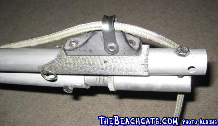

    That is a real PITA on a big wind day, you suddenly need gorilla arms to steer. If the tube that goes over the tiller bar is still OK, fix them. Realistically, the plastic cams will probably last as long as the little ears the unit pivots on.
    Buy the Clamcleat MIDI, they are only about $2.50 at West Marine.
    You need one clamcleat & 4 rivets,(3/16" Al) to rebuild each one.
    You can do it on the beach, just bring a cordless drill, rivets & rivet puller.
    Drill out 2 rivets that hold SS retainer onto clamcleat, it looks like a "U".
    Drill out 2 rivets holding cleat to pivmatic tube. Rivet new cleat to pivmatic. NOTE which way the rivet goes-head down.
    Drill hole completely through cleat, same place as old one.
    Lay rudder line into cleat & rivet "U" keeper onto cleat.(laying line before riveting saves undoing the knot or whatever you use at the end of the pulldown line)
    Go sailing with reliable rudders! I did the 5.0 this spring, it's a 1 beer job.Photo is the old cleats, note which way the rivets have to be pulled.
    http://www.thebeachcats.com/gallery2/main.php?g2_view=core.DownloadItem&g2_itemId=76947&g2_serialNumber=6
    Manually move your blades full up & down, & observe where the bungee rubs. This winter, take your rudder castings off, & remove the blades if necessary. Using a small file, or dremel, radius & polish that sharp casting edge, where the bungee rubs. Marine grade bungee will now last years. I have not touched the 5.7 bungee in 3 years.
