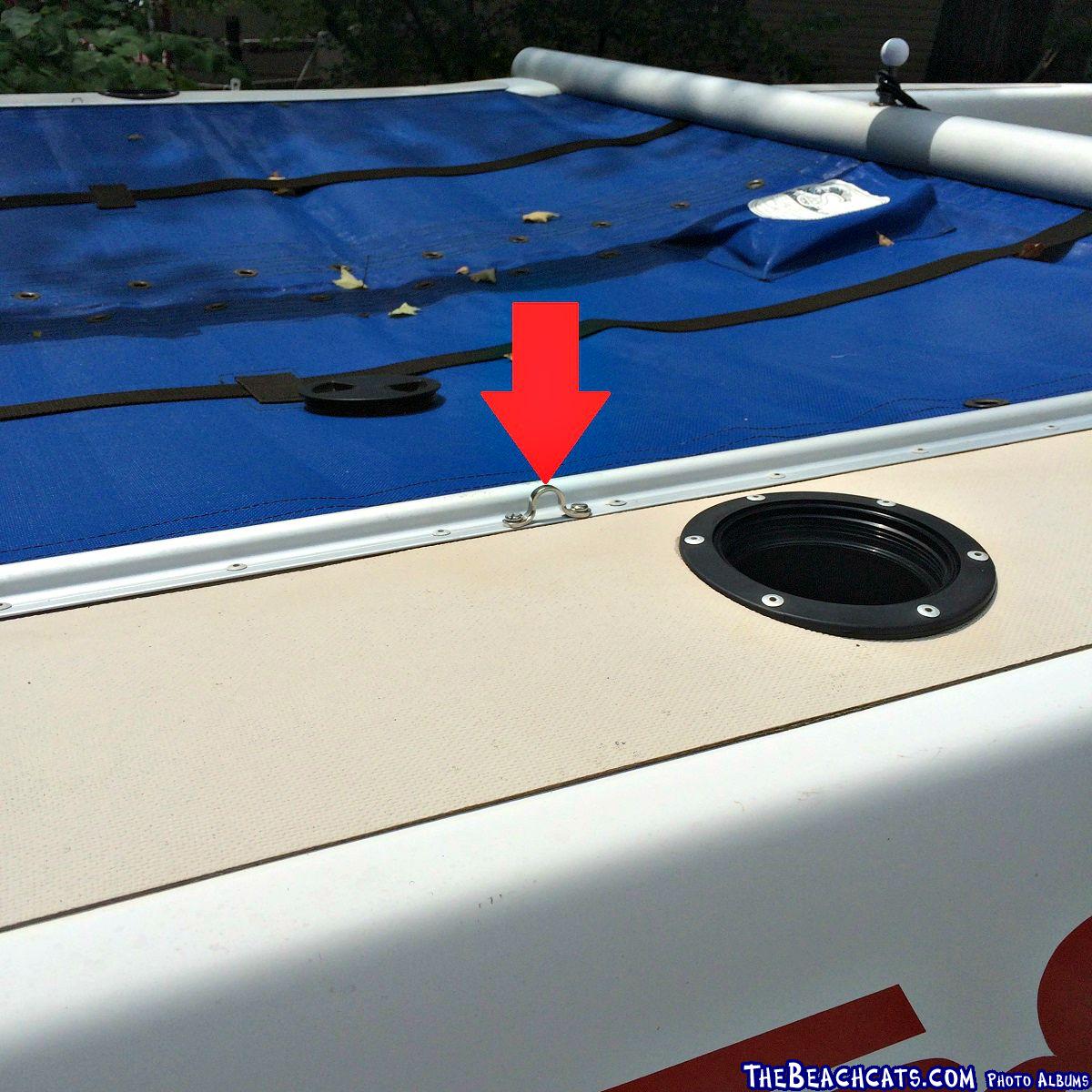

  • Hello everyone. I wanted to start by saying thank you for the posts on this site they have helped me in past years countless times.
    I just purchased a NACRA 5.0 and started sailing it last week. Up until the NACRA all my experiance has been with Hobies. Figuring out the rigging was not to difficult for the most part other than the crazy Pivmatic rudder system. I do have one question, my 5.0 is an 88 an I cannot find any details on how the jib blocks attach to the boat. Currently they are attached directly to the inside edge of the hull with no adjustment other than loosening or tightening the sheet. I have looked at some youtube videos in which I can see there is a way to get some adjustment but I cannot get a clear enough picture to see how it is accomplished.
    Ok now that I have rambled on. Does anyone have pictures of the jib blocks and how they are attached on a 88 NACRA 5.0?

  • Up until at least 1988, the 5.0 came with blocks mounted on a fixed point on the hull.
    They did not have the track, as do the 5.7's, & some other models.

  • My 5.0 is an '83 model. The jib blocks attach to the hull at a single, stationary (no track) eye strap:
    http://www.thebeachcats.com/gallery2/main.php?g2_view=core.DownloadItem&g2_itemId=119528&g2_serialNumber=3
    I haven't sailed the boat yet, but share what I think may be your concern which is jib lead angle adjustment.
    Eventually I'm planning to add a track and adjustable car so that the lead angle can be adjusted to suit the prevailing conditions and foresail you're flying.
  • I have an '84 5.7 with the same sail pattern as your avatar, & an '88 5.0. It carries blue/white sails.
    The '88 uses a single attachment point. If you don't have the stand up springs, try to pick some up. They are only a couple of bucks, & keep the blocks from banging on the hulls & marking them.
    I would not get wound up about having jib cars & a track. We have whipped that 5.0 to 20 mph(GPS) using the stock setup & 25 year old sails.
    On the 5.7, I hardly ever move them, only bringing the car rearwards in a big blow.
