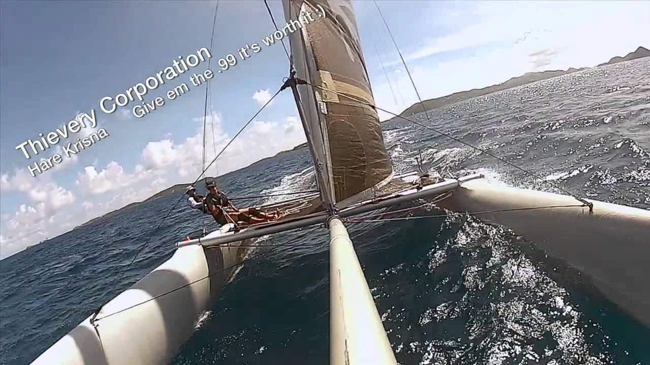

    the pelican striker?
    I do see a compression tube in this pic, i assume that is what you are calling the striker
    I would call it the forestay attchment at the bridal (parts that attach to the bows) but no need to nit-pick terms
    PS most beach cats do NOT have that "pelican striker" and may not know what you mean
