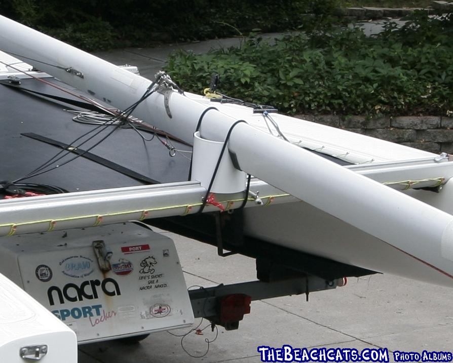

  • My Nacra I20 came with a piece of black ribbed drain pipe, about 14", 1' tall, cut to fit the mast on one end, and the rear beam on the boat on the back. I use a piece of carpet to wrap the mast before putting it it and wrap a ratchet strap around the mast to the rear beam. Works great. Can take a pic on Monday if you would like.

  • here's what i did. bought a short piece of PVC drain pipe from Lowe's or Home Depot, marked it with a pencil to match the shape of the rear crossbeam and cut the notches with a jigsaw. then i filed the edges smooth and added a piece of indoor-outdoor carpet under the mast. cost about $7.00. have to be careful when cutting. it slips over the traveler and keeps it in place right below the mast for travel. solid and secure.
