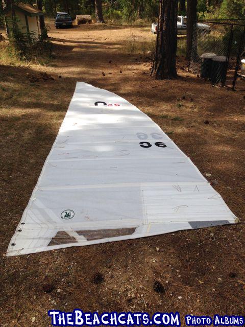

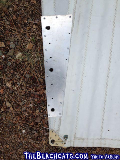

  • What is it, do I need one, or is my boat meant to have one? Nacra 5.5 uni.
    Thanks as always.

  • If you can easily move between those three holes, you need it a little bit less..

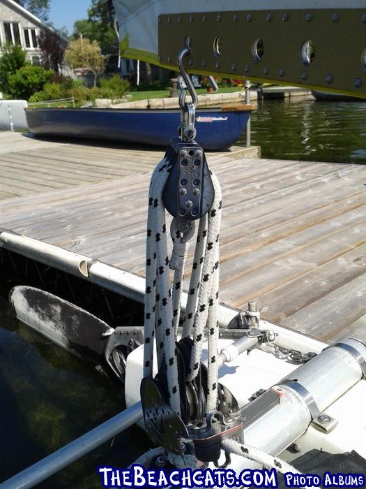

    A hook like this one may help (just got the picture from google, it happened to be from this site, of course)

  • Most of the boomless nacras just hook the mainsheet block into one of the holes in the clew plate. A few had a little boomlet. You should just be able to hook in I think.

    Ok. But what is the purpose of being able to sheet from a different position? What does it affect?

  • AndinistaIf you can easily move between those three holes, you need it a little bit less..
    http://www.israeltour.com/images/block.jpg
    I do believe I have the very same hook on the sail end of my main sheet blocks.

    I use an "S" hook on both boomless Nacras. It cannot be made simpler. Drop the "S" into the clew, & sail away. My record on the 5.7 is 7 minutes, & that includes going to the garage to get the mainsail.
    On boomless boats the traveler track faces a bit forward. This means sheet tension pulls the clew rearwards. Changing the "S" hook to a forward hole stretches the sail (flattens) & depowers the rig. In conjunction with more downhaul,(Flattens sail) this is a powerfull combination to de power the rig.

    Read the manual, light air use the rear hole, the more wind the more you move forward.

  • The ARC 22 is a boomless rig as well, although it has a significant tubular aluminum lower batten. We hook the mainsheet to the aft hole in the clew plate in light air, and move it progressively forward as the wind picks up, mostly to reduce mast rotation, which reduces the sail's draft. Works well on this boat.

    I have read every word in the one manual with the photo on the front, of the boat from above. I went over it again today. Never is there the words 'clew traveller' and the only thing related to that setup is very vague (and the pictures are almost unrecognizable in those scanned manuals). I had overlooked the second manual, with older typeface, until now. I study up on that one too, it actually looks a little better.
    From the newer manual: "Instal upper block to traveller car [are they talking about a clew traveller?] with 1/4" shackle or 'S' hook. Instal lower block to traveller with 1/4" shackle. Adjusting fore and aft will affect sail shape." Hmmm...

  • Being an 18^2, I'm thinking your boat had a clew traveler fitted at one time. the clew plate looks a littler weird IMO compared to the boomless Nacra clew plates that I have sailed.

  • Pre 1990 (or so) Nacras had clew plates, after that they went to a clew traveler. This was a piece of Harken track with a traveler car and cleat. The traveler would allow for adjustment on the fly. As the wind picks up you want the sheeting point further forward to help flatten the sail. Downwind in light/medium air we used to release the clew traveler completely to give the sail some more shape.
    Boomless rigs are not "lower performance". Nacra used them on all their boats until the Inter18 came out. The overall adjustment of the sail shape is more limited. The main disadvantage is the adjustment of the mast rotation. Upwind it is difficult to adjust to anything other than where it naturally wants to be. Also, moving the traveler has a more significant effect on the overall shape of the sail than on a boomed rig. For recreational sailing there is nothing better than not having a boom in the way and for racing its not an issue either.

    You are probably right. Seems like I should be able to hook in OK anyway and manage just fine.

    After we were talking about adding a boom to your cat I think I would try it as a boomless first. After looking at your sail set up and your pictures of the original beams I can see that this is one of the early squares that had the boom attach to the front beam. The sail in the picture looks like a modified sail with the added clew plate to eliminate the boom. I think I would stick with this setup for a while and not add a boom and see how it works.
