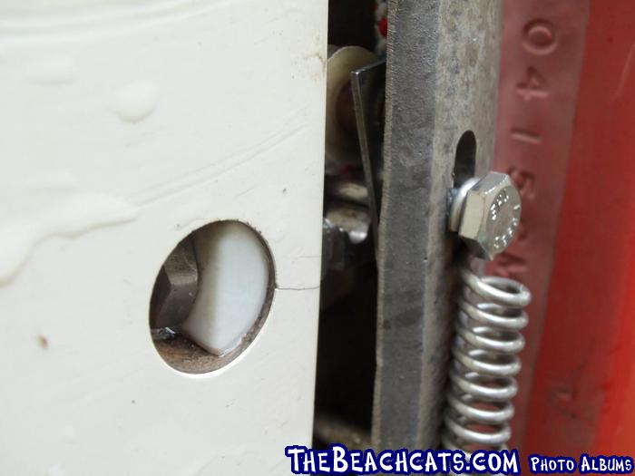

So, here's a question: the description of this photo mentions that adjusting the lock bolt in or out controls the "break-away tension of rudders" I thought this adjustment would control the angle of rudders, which together with mast rake determined whether/how fast the boat turns into the wind. Is my understanding incorrect? If so, what is this "break-away tension of rudders" - the amount of force required to pop them up? I ask because one of my rudders is WAAY too easy to pop up by hand and did indeed pop up in the water making the boat all but unsteerable. I assumed this was because the hole in which the lock bolt screws into got pushed down a touch - is my problem simply that the bolt is not screwed in far enough?

On the Prindles, the lock-bolt adjustment also adjusts the rudder rake but to such a small degree that rudder rake is not an issue on these boats, same with mast rake. If your rudder is popping up when you are sailing then you need to adjust the break-away tension of the rudder at the lock-bolt. There are 2 nuts on the lock-bolt, loosen off the outer nut, adjust the inner nut to shorten the extruding part of the lock-bolt, finger tighten the outer nut, lock rudder down, grab rudder on bottom and pull untill rudder breaks free, adjust break-away tension untill you're satisfied. Some get real technical and use a gage to adjust break-away tension, I just use my arms and guesstimate. Remember, when you're satisfied with your break-away tension to lock down the 2nd nut onto the 1st nut, but always make sure that the leading edge of the lock-bolt is parallel with the lock-pin, this will reduce wear on all mechanisms and ensure good lock-down contact with lock-bolt and lock-pin.

Mike, the lower pin is the anchor-pin, it does not move....
The upper pin is the lock-pin and it does/should move vertically.....
If you are referring to vertical play on the lock-bolt located in the rudder, not good, the lock -bolt should have no play. Instead of using duct tape as a shim, see if you can use a hollow metal/aluminum tube, sort of like a bushing. Hole in rudder in which lock-bolt sits has been enlarged, find tube that fits hole and that lock-bolt fits exactly, no play. -

Yep, that's the one that has the play - the lock-pin hole. Not enough to put any metal tube in it though - none that I can feel by hand, in fact. But after I lock the rider and pop it out, I can move the lock pin down by a smidge. I've been playing with it just now, and it's certainly getting tighter as I screw the lock pin further into the rudder.
So here's another question - is there such a thing as a too high "break-away tension of rudders"? My "bad" rudder now takes a considerable effort to unlock if I hold the blade under my armpit tiller up and push away on the tiller with the other arm. The "good" rudder, however, locks too strongly for me to unlock in that fashion. So, is my "good" rudder over-tight, or do I need to keep tightening the "bad" rudder?

I was hoping that as you tighten/shorten the lock-bolt, it would tighten up in its seat, hopefully thats the situation in your case. When it comes to break-away tension on your rudders, just think of the force acting on the gudgeons and pins when the rudders hit an obstruction, could tear your transom off, so adjust your tension accordingly, enough tension so the rudders stay down when sailing at speed, but will pop when hitting something, that is guesstimating. Just play with the lock-bolt adjustment untill you're satisfied, I usually do this with boat on trailer, rudder locked down, I sit on the ground behind the rudder, grab the bottom and give a sharp, energetic tug. Repeat process on other rudder.

Thanks for all the details. It did tighten up, I think, as I screwed the lock pin further into the rudder. I have no reference for what it takes for the rudder to stay down while sailing at speed, but I think it's now strong enough to try on the water. I may loosen up the other rudder a touch though...
