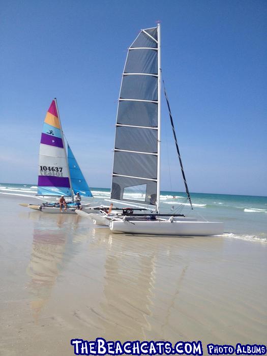

  • Note: Hobie wings have a max load of 450 lbs. Don't ask me how I know. Mystere 6.0, 6.0xl, 5.5, and 5.5XL could be ordered with wings. I retro fitted a set of Hobie 18SX wings on my M6.0. Prindle and Nacra offered a wing retro kit. The wings slide into the crossbars. I have even seen a set of those wings on an INTER 20.

  • WOW ! looks great and looks just like my Technora sail
    http://asnstudios.com/images/cat.jpg
    Can you post a few close ups pics of your wing attachments (where they marry the beam)
    Quote I retro fitted a set of Hobie 18SX wings on my M6.0.

  • mystere 6.0 with custom wings
    http://asnstudios.com/images/wing.jpg
