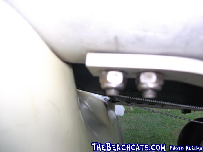

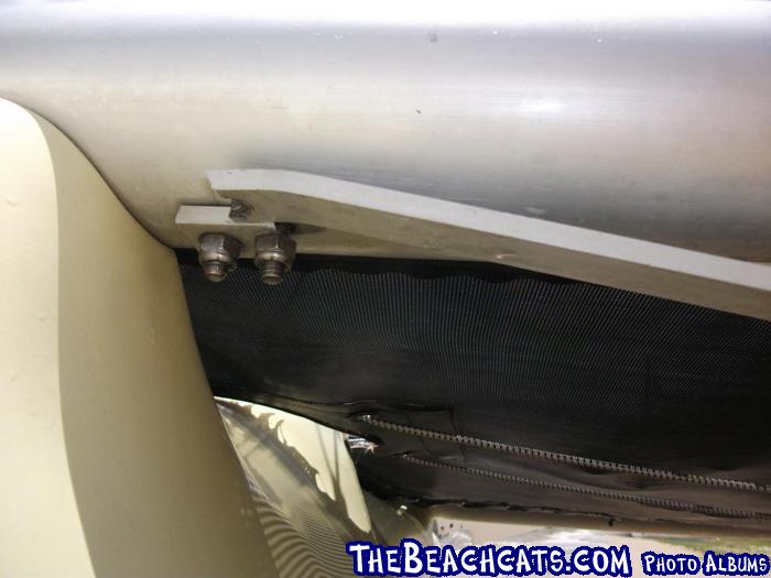

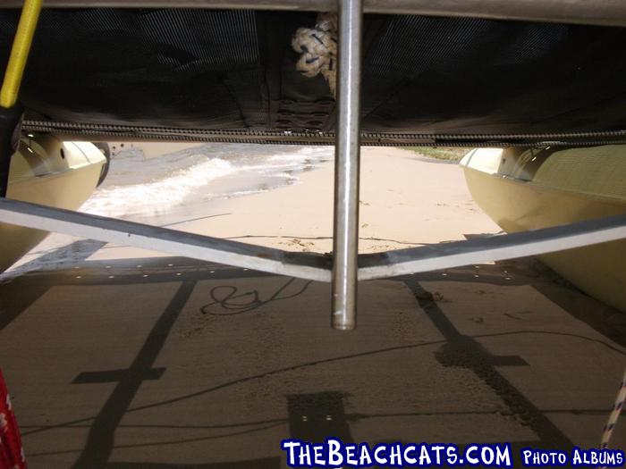

  • replaced mine with all new from murrays...only because the stops for the mast rotation on mast and crossbar were well worn to the point I was afraid the mast would ramp off of the base. new ds rod didn't have hole in bottom to attach screw to so I did without...until the big wind day. then after replacing the crossbar and new mast base parts, I drilled and tapped the ds rod this time. bottom line...if your new/old rod/mast base set up keeps the strap to within a 1/4" flex, your cool. no need to adjust the frozen parts if they are right. just for giggles, inspect the crossbar where the double bolts attach to the strap...small cracks start there after your ds rod jumps out of the hole because you didn't drill and tap the set screw icon_cool
    http://www.thebeachcats.com/gallery2/main.php?g2_view=core.DownloadItem&g2_itemId=88211&g2_serialNumber=6
    http://www.thebeachcats.com/gallery2/main.php?g2_view=core.DownloadItem&g2_itemId=87697&g2_serialNumber=6
    http://www.thebeachcats.com/gallery2/main.php?g2_view=core.DownloadItem&g2_itemId=87694&g2_serialNumber=6
    I would tighten the ds rod each day and it worked until big Wednesday!
