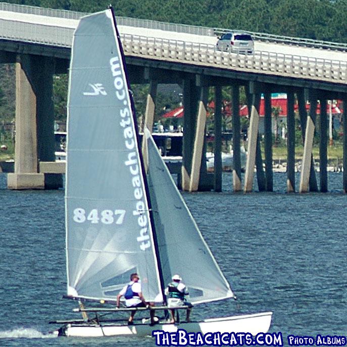

    Tell us about your boat? A late model (post 1989) Hobie 18 is the best performance improvement. A Pentax SquareTop sail is a good value if you are buying new sails anyway.
    Smaller things like the new EPO3 rudders, bottom job, good condition daggerboards, will all make a difference.
    The Hobie 18 sail plan includes a large overlapping jib. It usually doesn't work to modify designers plan that works. The only way I could see improving with a smaller jib would be to use the entire rig from an F18 including the mast, but no way to know if the boat would be balanced. The best you could hope for would be a boat that looks like a slow F18.
    But you haven't told us about yourself? You say you aren't racing, the Hobie 18 is really fast and powerful (like nearly all beachcats) in stock form, unless your water is full of rock stars on the latest high-tech catamarans you will already be the fastest thing going.
