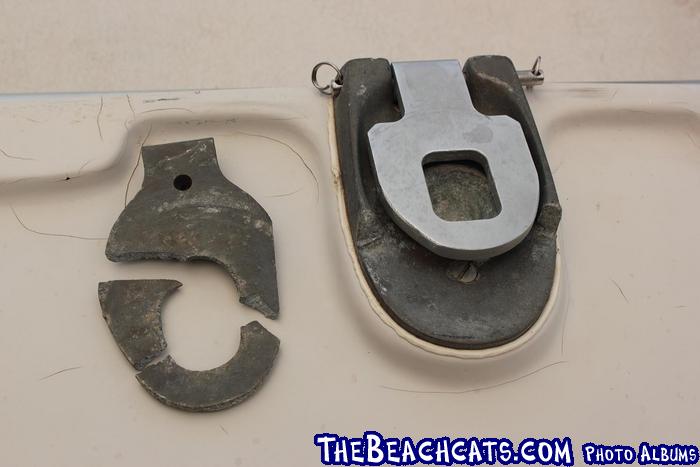

  • Aaaaaight! Looks like it's the same part that broke on mine. But I think I busted mine worse. Here's a picture of my broken part and the replacement I made:
    http://www.thebeachcats.com/gallery2/main.php?g2_view=core.DownloadItem&g2_itemId=87324&g2_serialNumber=4
    I made it out of 6061-T651 aluminum. Nothing special about the alloy, except that it's more ductile than the original casting, and should be able to take more abuse. It's just what I had on hand. I think the slab I started with was 1/4" thick. Except for the hinge part where the pin goes through, which was left full-thickness, I had to machine the rest down enough that the mast base would be able to fit through it and rotate. (I think that wound up being something on the order of 3/16" thick, but this is from memory.)
    The biggest mistake I made was in tracing my busted part onto the slab and trying to do most of the work on the bandsaw. The original castings were an awful mishmash shape that really don't need to be duplicated in a new part. You can see some remnants of this in the shape of the part I made. Honestly a much cleaner profile could be made from the get-go, resulting in a nicer part that's just as functional.
    This is something just about any machine shop could knock out in an hour or so. If you like I can measure mine and send you a drawing of it. I don't know what a shop would charge for this, but it shouldn't be too much.

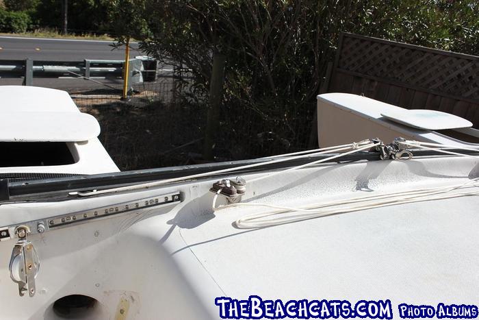

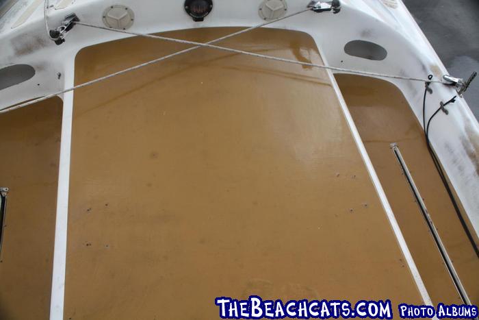

  • Here are some "Before" and "After" pictures of the P-Cat. They show all of the lines that were, frankly, in the way. We cleaned them up and the boat does not know the difference.
    http://www.thebeachcats.com/gallery2/main.php?g2_view=core.DownloadItem&g2_itemId=98632&g2_serialNumber=4
    http://www.thebeachcats.com/gallery2/main.php?g2_view=core.DownloadItem&g2_itemId=98635&g2_serialNumber=4

    Our P-Cat is rigged very differently from either of your photos. Not saying it's right, just saying it's different. It matches, as closely as possible, the rigging diagram in Royce's Sailing Illustrated (which pictures a P-Cat 2, not a P-Cat). I'm not that keen on it. But I'll describe it, anyway. Again, no photos of the boat rigged. But I have enough other photos I can probably piece some of this together.
    The jib has long leaders that go back to single-sheave blocks. When sheeted in, those blocks almost reach the rear crossbeam of the boat. (LONG leaders...) The rear crossbeam has two tracks, one on each side, with a block and becket on each track. You can see one of them in the left side of this photo:
    http://www.thebeachcats.com/gallery2/main.php?g2_view=core.DownloadItem&g2_itemId=84580&g2_serialNumber=4
    The rigging starts at the becket, runs forward to the jib block, runs back through the block on the rear crossbeam, and then forward (again) to the cam cleat block located on the front crossbeam:
    http://farm8.staticflickr.com/7076/7397850030_e880830f01_z.jpg
    The free end then goes back through the same pattern on the far side of the boat. So the jib sheet is continuous.
    The way it's rigged in Royce's Sailing Illustrated, the jib sheet crosses the deck and goes into the cam cleat on the opposite side. This puts the sheet right in the hands of the crew as it exits the block. This also drives me and my wife nuts since we learned to sail on a Prindle 16. So we don't rig it that way. The port side rigging stays on the port side, and the starboard side rigging stays on the starboard side.
    So on to Jeff's rigging:
    First, do you guys have a spinnaker on that boat? Because there are some lines on there I'm not familiar with. There are some screw holes on my hull that have been filled in that match some of the stuff I see on Jeff's boat, so I'm curious.
    In your second photo, it looks like a much-compressed version of what I'm running right now. But instead of having the jib block at the rear crossbeam, you've got it on the sidestay. How does this work for you? And do you have that 2:1 purchase on the jib sheet, or is it a single-purchase?
    I really really like how clean the rigging is in your second photo. It's about as close to a modern cat as I could imagine a P-Cat getting. I'm not all that keen on how my jib sheets run back and forth along the length of the deck. Even when everything is running neat, it feels cluttered. I'm constantly tripping over jib sheets.
    At some point I also need to pick your brain about the mainsheet traveler. It's very different from the one I'm using. Another P-Cat sailor said the traveler really needs 3:1 purchase in order to have the oomph to move the traveler when sheeted in. Mine has 3:1, but it's not the nicest setup in the world. There are a number of other 3:1 purchase travelers that seem like they'd be a lot more pleasant to use. Do you mind describing how Jeff's is set up?

    I also see you've still got the hooks for the hiking straps, but don't have hiking straps installed. Our hiking strap holes were filled in. I've been toying with the idea of replacing them, but haven't decided one way or the other yet. I kind of need to figure this out before doing the gel coat work on the deck.
    Sorry to keep going with the questions, but I see the two hatches in the front crossbeam. That's one area I haven't managed to photograph inside the hulls. Any chance of sticking a camera in Jeff's hulls at that point? I'm curious what's underneath the mast. When I installed my new cam cleat blocks for the jib, aluminum bits came out when I drilled the holes. So it seems like there's aluminum embedded in the fiberglass. It would be nice to know if I'm right or wrong about that.
    LOVE the compass. That's seriously cool. I hadn't thought of using that area for mounting instruments, but it seems obvious now that I'm looking at it.
    How did you guys get the two-tone pattern on deck? I'm planning to do some gel coat work on my deck in the not too distant future, but we've got alligator cracking all through the textured parts of the deck (brown in your photos). I don't mind doing different treatments on different parts of the deck. Did the boat come that way, or was that something you guys did?

  • Tom, I’ll answer what I can, but Jeff is now a member of Beachcats and will probably chime in on this.
    Re: dagger boards, I have not seen the aluminum strips you referred to or any rubber at the bottom of the dagger board wells. Instead there is flimsy piece of what looks like thin styrene with a slit in it at the bottom of the well. The dagger board slides through this and that is all there is to the whole system. The dagger board well tapers up along the sides of the well so that there is a considerable gap between the side of the well and the topsides of the dagger board itself. Consequently with no lateral friction, the dagger board is free to move aft and retract depending on where the loads are coming from. Our dagger boards settle all the way down too, until they hit the rope stop.
    Re: rigging, in talking with Jeff, he tells me this was the way he purchased the boat and assumed it was the standard P-Cat rigging system. Like you said, it may not be right or wrong, just different. As crew, I was in charge of the jib, and being as careful as I could, I still got tangled up with the many lines on deck. I cut myself many times on the small cleats when I planted my knee in shuffling over to the other side. I looked at the system carefully and made my suggestions to Jeff. He was reticent to change, his thought being that he wanted to keep the boat as stock as possible. He eventually acquiesced and we significantly reduced the number of lines required to sail. Like the famous architect Mies van der Rohe said, “Less is More”. We now just have one line on each side of the jib going through a rotating cleat on the forward crossbeam. We filled in the holes, and although they look like they are just raw holes in the “After” picture, they are absolutely flush with the surface of the deck. I asked Jeff for his honest opinion after we sailed it like this and he gave a thumbs up.
    Re: Jeff’s rigging, we do not have a spinnaker on the boat. On the traveler car, we had it actually come off while sailing. One of the end stop-screw’s head broke off and the car ran right off the traveler. Fortunately, Jeff was Johnny-on-the-spot and grabbed almost all of the ball bearings. We locked it in place and made for the dock. I made a custom jig to hold the ball bearings in place and we carefully slid it back into position and replaced the end stops. I am not nearly as familiar with P-Cats as you, but Jeff’s boat does not have a sliding adjustment for the traveler car. It does slide, but it is not the pull-push system you find on monohulls. You have to manually move it. Jeff will have to answer this in greater detail. Our hiking straps are removed at this time because we took the mast and all of its attendant rigging apart as well. (There is a very interesting story that goes with why the mast step hinge is broken, but I will leave that alone for right now).
    Re: inside the hulls, those two hatches are SO handy. We keep a pair of pliers and the halyard crank in one side and bungees for the mainsail in the other. I will ask Jeff if he can shoot inside the hull and get what you need.
    Re: the compass. I dismissed it early, but now I use it all the time when I am captain on the boat.
    Re: the paint job, the base color is a brown/mustard hue with white painted trim. The white is wearing off in some areas. I’m pretty sure he got the boat that way. I have hinted that the boat would look awesome with a new paint job, but that can be expensive and I understand his reticence.
