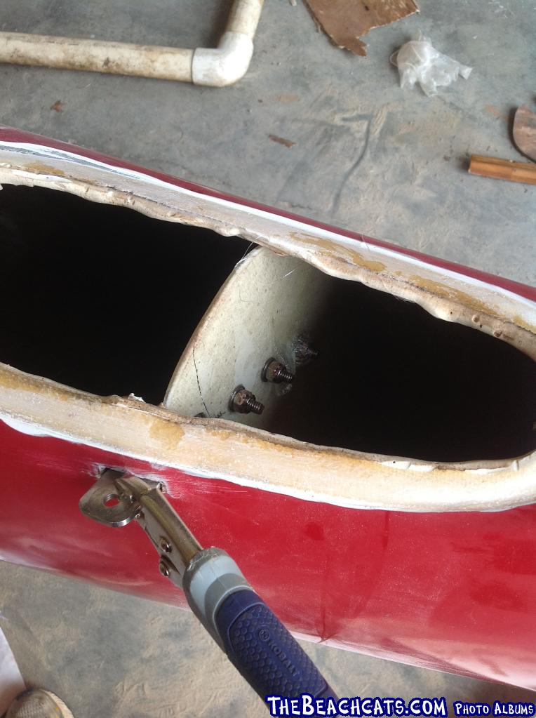

  • Not sure how your boat is made but i just fixed a similar problem on my Supercat. My boat had a bulkhead glassed in the hull that the bow tang was bolted to. My bulkheads had come loose and were about to pull out. It ended up not being a terribly hard fix, it was my first big repair attempt too. I just created an album that shows that repair, check it out it may help you.

  • We have 8 - 18 SqM @ our club on Lake Norman (LNYC.ORG). The boat can definitely be fixed, and you should probably do both sides @ the same time. We do have some hulls but they've been experimented on and I would question their structural integrity. If you can find an old 5.5 the hulls are the same. If you're interested in selling the sail let me know, we have some new owners that are evaluating buying sails and might be able to sell it to one of them.

    I have an nacra 5.5 18sq that i am doing some glass work on - you may need a "splash mold" taken off of another 5.5 to get proper hull shape.... this is a mold taken from the outside of another boat that you use to build up from the inside of your hull..... useful when you need to do a complicated shape like where the forestay comes out of the hull... where are you located? - I needed a splash mold for where my beam bolt came out of the hull - I just spend many hours trying to shape the area back to something that looks like the other hull..... I can make a splash mold pretty fast if that will help..
