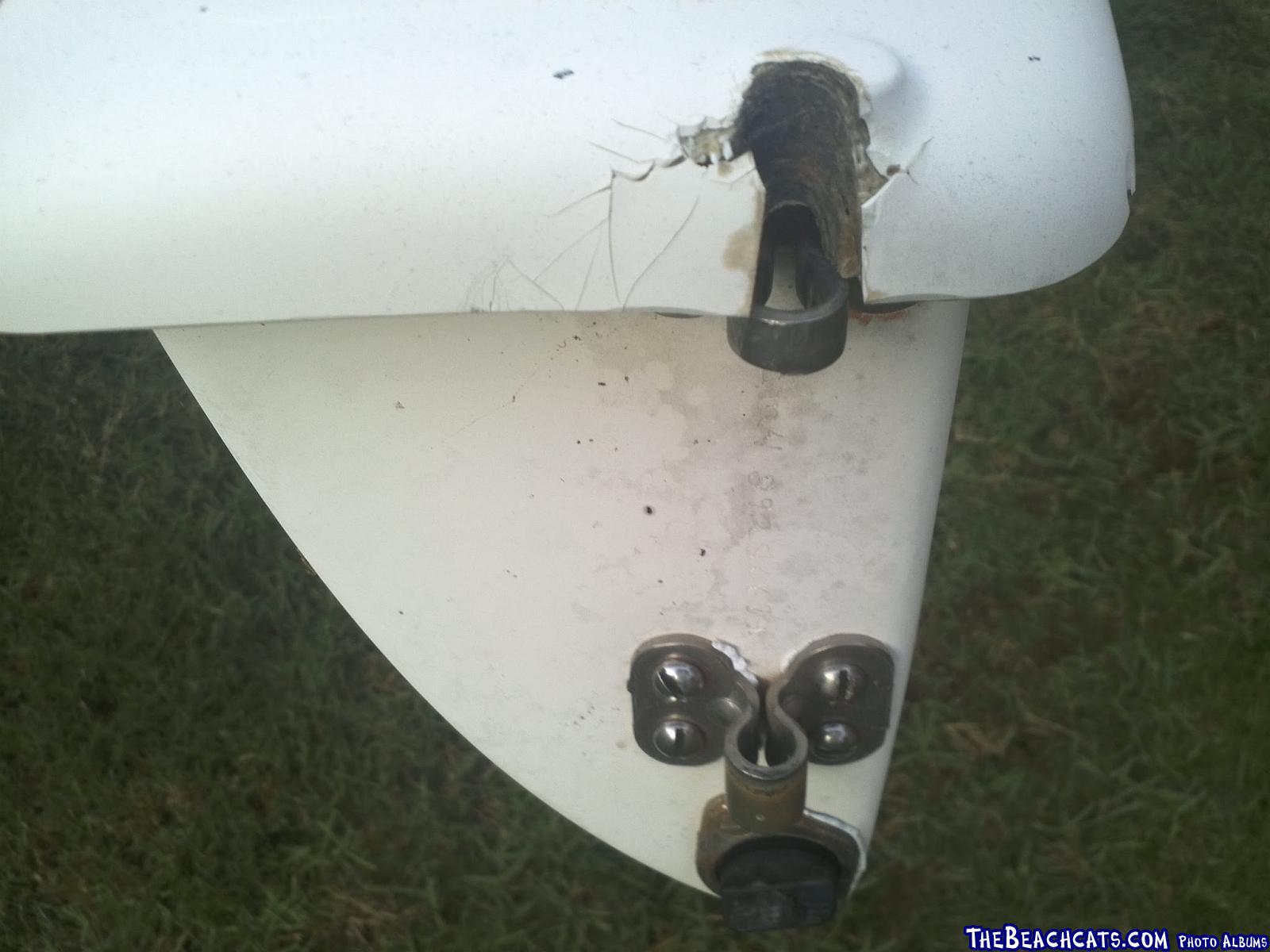

  • This Hobie 14 I'm fixing up has the broken deck lip at the stern where the rudder pin hold is supposed to be. I've seen this type damage on a lot of Hobie 14 & 16's. Since the area is solid fiberglass I'm thinking I can just dremel away any loose parts and fill with marine tex to smooth it out. Doesn't seem worth getting into actual fiberglass work.

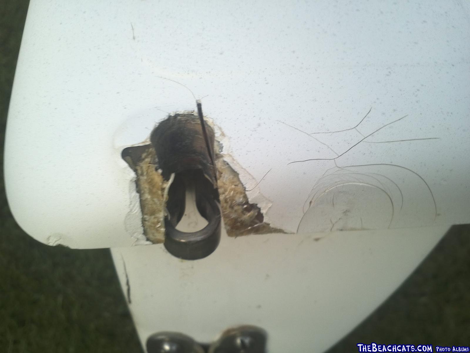

    On the starboard side it looks like someone used a hacksaw to remove loose glass and cut in too far.
    Any suggestions for a quick stable fix?

    It is hard to tell how deep the damage goes on that right hull, but really glass is so easy to work with, I would grind it away, on a bevel, with the angle grinder, use any 6 mil sheet of scrap plastic sheet as a form & lay up 4 layers of woven roving at a time. It would only take an hour or so, then, using the gudgeon as a guide drill upwards through your work.
    It will be as strong, or better than new.
    If you want it to look really good, finish 1/16" below fair, then use a gelcoat kit.
  • You're right, Damon.,,,,the hole is just a place for the pin to go through...no other purpose. Just smooth it up and seal it good so no water can get in the laminate. I have rebuilt one with just thickened epoxy, but it was only cosmetic.

    rattlenhumYou're right, Damon.,,,,the hole is just a place for the pin to go through...no other purpose. Just smooth it up and seal it good so no water can get in the laminate. I have rebuilt one with just thickened epoxy, but it was only cosmetic.
    Thanks Jerome, that's what I thought. I'll leave it to the next owner if they want to pretty it up.

  • Damon, get some Sorlarez Extreme, pick a sunny day and you can have that filled in with a minimum of effort, and it will be strong. http://www.solarez.com/productsnew/e_extreme.html
