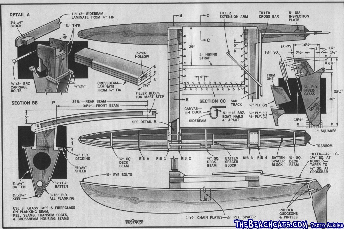

    I think that you want to build your own small beachcat? You probably wouldn't be here asking questions if you were a boat designer so you'll need plans. For a beginning builder you might do well to look at an old design that can be built from simple materials, even the mast!
    I give you the Hobby Kat from Mechanix Illustrated
    http://thebeachcats.com/p…158&g2_imageViewsIndex=1

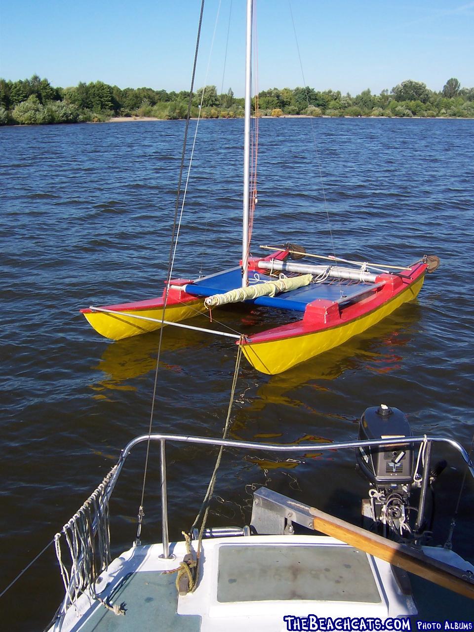

    Here's some pictures of one that was built with modern beams instead of wood.
    http://thebeachcats.com/pictures/?g2_itemId=35086
    http://www.thebeachcats.com/gallery2/main.php?g2_view=core.DownloadItem&g2_itemId=25363&g2_serialNumber=4
    http://www.thebeachcats.com/gallery2/main.php?g2_view=core.DownloadItem&g2_itemId=27631&g2_serialNumber=4
