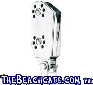

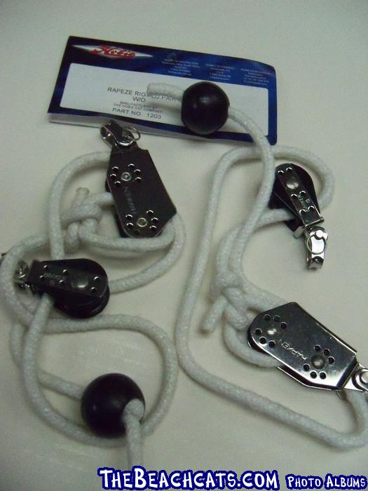

    If you want to get fancy since you're replacing parts already you can convert it to an on-the-wire adjustable rig with a v-jam block or a clam cleat.

    V-Jam Block
    http://www.thebeachcats.com/gallery2/main.php?g2_view=core.DownloadItem&g2_itemId=87655
    V-Jam rigging:
    http://www.thebeachcats.com/gallery2/main.php?g2_view=core.DownloadItem&g2_itemId=87657

    [quote]V-Jam rigging:
    Isn't that a waste of the double fiddle block?
    By using one sheave to dead end the line, you have wasted that sheave.

  • Edchris177]V-Jam rigging:
    By using one sheave to dead end the line, you have wasted that sheave.Edited by Edchris177 on Jun 19, 2012 - 07:09 AM.
    That's the contents of the Hobie adjustable trapeze kit so maybe they have some reasoning for it. But yeah, you could probably go cheaper with this single sheave Ronstan V-Jam
    http://ronstan.com/images/product/RF341.jpg
    You could also switch the single block for a block with a becket. Then you could utilize that second sheave and get 3:1 instead of 2:1.
    I've trapped on boats with the Hobie system and the clam cleat setup and prefer the clam cleat.
