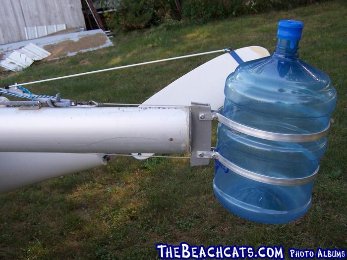

  • what you should do is flip on purpose so you not as scared as flipping but make sure you mast is sealed,
    or you could do this
    http://www.thebeachcats.com/gallery2/main.php?g2_view=core.DownloadItem&g2_itemId=79093&g2_serialNumber=4
  • i was just looking at that! super awesome, and super ghetto. I love it.
