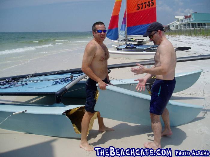

We had a P-16 totally fall apart from soft hulls last weekend at our beach, it truly collasped with the mast falling down with 3 people aboard. This is the 3rd boat in the past 12 months. A H-16, P-16 and a P-18. All were newer than your boat. Your boat is 36 years old, it is remarkable that they last anywhere near that long. Material fatique just happens over time to include the aluminum and stainless parts as well as the foam sandwich construction. Safe has a different meaning to different people. -
