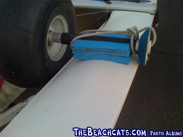

What I do when i need to move it by myself, and that happens a lot, is I position the wheels in front of the hulls and lift one side a little and push that side in a bit. I kind of stand in front of the axel so it can't move much and move to the other side and do the same thing. I just kind of walk it back a foot or so at a time. until they are under the shrouds. Then loop the ropes or tie them in place.
If you don't have cradles make something like this to help it stay in place.
