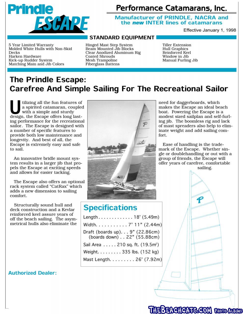

Well I have never sailed in the Ocean but I can vouch that a P18 sitting in light wind getting bombarded by ski boat and jetski wakes will bounce all over the place.
I found a PDF that says it is a Prindle Escape Manual but it look more like a spec sheet that list the following standard equipment.
5 Year Limited Warranty
Molded White Hulls with Non-Skid Decks
Harken Hardware
Kick-up Rudder System
Matching Main and Jib Colors
Hinged Mast Step System
Beam Mounted Jib Blocks
Clear Anodized Aluminum Rig
Coated Shrouds
Mesh Trampoline
Fiberglass Battens
Tiller Extension
Hull Graphics
Reinforced Keel
Window in Jib
Manual Furling Jib
I found the bold items to be interesting and a plus to buying an escape.

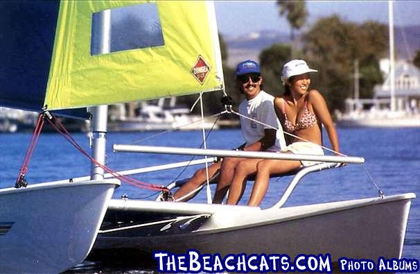

The Picture shows a Bow Foil in use with the furler as well instead of the standard bridles. The extra length of the boat must allow the movement of the Jib blocks to the beam which is a huge plus in my book
it says:
Anyone know what the CatRax system was?
If the price was good and I could afford it I'd buy it in a heartbeat.

Prindle Wings
If anyone ends up with more Escape material, please put it here.
