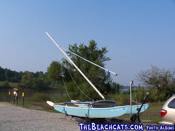

    Seriously, there are lots of solutions to solo mast stepping, it depends on the boat and what is the main problem. There are commercial solutions available from Murrays.com and many versions of home-made rigs.
    This one is kind of representative of how they all work.
    http://www.thebeachcats.c…pictures&g2_itemId=53380
    http://www.thebeachcats.com/gallery2/main.php?g2_view=core.DownloadItem&g2_itemId=53420
