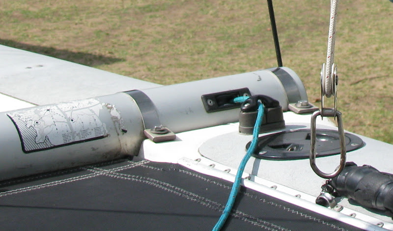

  • Quotei have moved the jib blocks out a smidgen and might try a bit further out, (to reduce the backwinding) and forward (as the top tell tale still breaks first) but i'm trying to avoid the added sheets and cleats of a barber hauler system which seem of marginal benefit with the short length of our downwind gybe sections
    Here's mine. The line has an SS ring tied to it that the jib sheet runs through. So really, there's about 2 feet of line and a ring on each side. Really clean way to do it on a 52:

  • Yurdle please bear with me. I don't see ANYthing holding your jib line. I have an old Prindle 18, and my problem is the jib blocks cleat no matter what is going on. I cant get them at an angle where they can uncleat without a hand right by the block pulling the line away from the cleat. At any tack, jibe or beaching, the jib line has to be forced away from the cleat so slack can pay out. At times this has been a dangerous problem.

  • Yeah, I think I know what you did with the barber hauler but if you could get a pic zoomed out a bit I would like to see how the whole system works. I like the idea of running one of the lines through the front beam!

  • Wolf - The 18 has a different system than the 18-2, which is what has the 4-way. The 18 you set and forget with a single line going between the jib blocks. The line runs through some grommets in the tramp that can move the blocks forward and back a touch, depending on the grommets used. You can't reasonably adjust it on the water.
    I'll try to find another pic. I was just looking through pics on my network for that one -- I don't have the opportunity to go take one before next week, as there's an event in Houston this week I think I'm going to have to attend. =)
    Pirateboy - you might have to use some imagination, or else be more specific about how I can help. I don't think this setup is technically impossible on a P18, but its pretty impractical the way the main beam is set up, especially since most P18s already have a barberhauler.
    As far as the cleating issue, if you've already tried adjusting the cleat position on the block, try using a larger line. 1/4" line on a jib sheet can be a total bitch to pop from the cleat if the jib backwinds. 3/8" practically jumps out.
