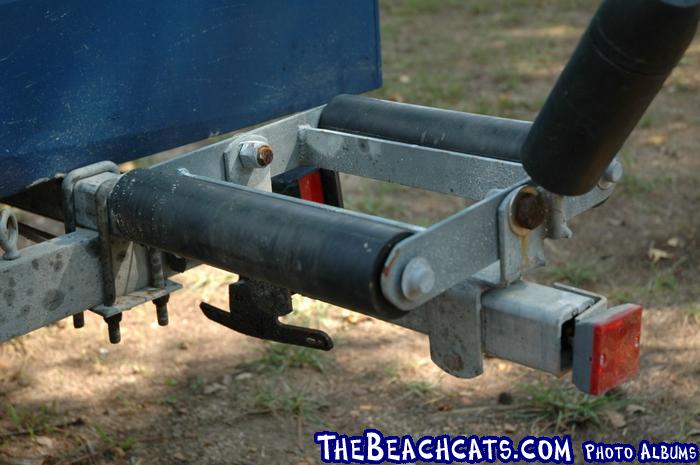

    Actually with a Hobie 18 even the single rollers are not a problem, unless you are planning on allowing snow to acumulate!
    But upgrading your single rollers to doubles will nicely spread the load and also make loading unloading easier.
    Here is a pic of mine, I have them front and back.
    http://www.thebeachcats.com/gallery2/main.php?g2_view=core.DownloadItem&g2_itemId=35060&g2_serialNumber=4

  • Hi All
    Thanks for the info. I like the idea of double rollers, are they from the trailer company? (I haven't a clue who made my trailer, there aren't any stickers as far as I can see).No problem with snow accumulation here in Tallawhacky.
    There is some "repaired" PO damage to one of the hulls right above the rollers, so I want to do something. I'm leaning toward the 2x8 or 10 with carpet idea so far. Pics would be great!
    KK
  • Quicke Update.. It is a MagicTrail by MagicTilt, I had to crawl under the damn thing to provide y'all with that info, hope you appreciate my effort. Gonna try and find the double rollers to see how much they cost.
