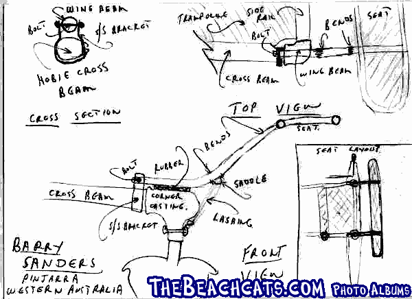

  • Lots of people have tried to build their own wings, I've seen a few versions. One of those things that is easier thought of than done.
    The SitNsail wings were very well done, unfortunately the owners have stopped production due to health issues. Last I heard they were looking to sell the business and patents.
    Here are some drawings of homemade wings for a Hobie 14 which has the same structure as a H16.

    If you end up building wings please take lots of pictures and document the process for the next beachcat sailor.
