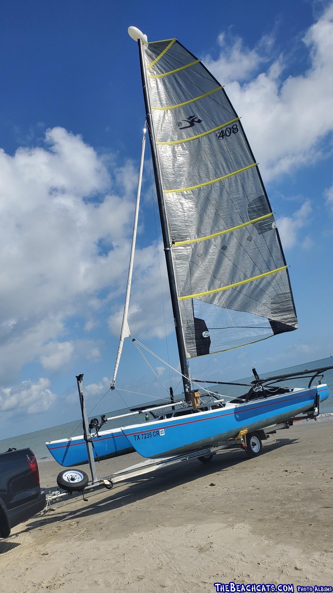

- Registered: Jun 30, 2018
- Last visit: Aug 04, 2025
- Posts: 602
- Posts: 602
Actually turned out rather "swell". Had to add velcro wraps on top and bottom, but the covers also have elastic cords sewn into them I leave tied loosely as to not lose them. Sunbrella type fabric with a firm, pipe insulation core. $32 and looks like it's made for the purpose.
Chuck C
NACRA 500 Mk2
Hobie 21se (sold)
- Last visit: Dec 04, 2024
- Posts: 7090
