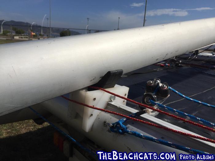

  • I support my mast on two v rubber bow bumpers, track down. When I travel long distance, typically 500 km, I put it with the track up, unless I’m too lazy to rotate it. The front piece that takes most of the weight, touches the diamond spreaders. I have padded metal pieces at each side and the v-block goes through a bolt between them. I don’t need to tighten in excess the strap or rope that holds it, because it won’t pop out and fall. If it was supported only by the v-block I’d tighten more and be more concerned about the track.

  • I'm happy with what I've got, perhaps I'd change the rubber bumpers for plastic ones and at the front maybe a roller instead of a V-shaped could work, depending on the width. If possible to make a support with the shape of the mast section, even better, no idea how to do that.
    The main advantages that I looked for:
    Front:
    - The side supports (metal piece covered with blue pvc hose) extend well above the the mast, so the risk of mast falling down on the road is lower
    - diamond spreaders are attached at that support too, keepin the mast in place longitudinally.
    - The side supports limit mast rotation on its own axis.
    - Both things allow not to tighten in excess at that point.
    Rear:
    - The fact that the front support limits rotation, allows for a simpler rear support.
    - There less weitht to support here so I don't need to tighten in excess either.
    - Make it high enough to support the mast above the tiller cross bar (I didn't thing of that, need a bit more actually)
    https://www.thebeachcats.com/gallery2/main.php?g2_view=core.DownloadItem&g2_itemId=132602&g2_serialNumber=4
