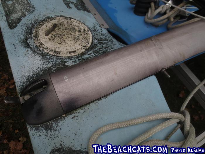

  • QuoteHobie 18s used to come stock with the pop style hatch. I'm not sure they even make them anymore. Basically they resemble the round screw type hatch, but have a loop of line that you pull to "pop" the hatch loose. To close, you snap it back down into place. I think these are obsolete, replaced with the screw type.
    Bill has this correct. Here is one on my ‘84 H18 Magnum, (before I restored it). The handle is simply a piece of thick line with the ends pushed through holes in the lid, then stopper knotted on the underside. Of course this means they have to leak.
    https://www.thebeachcats.…120280&g2_serialNumber=4
    I removed them both, & replaced with Hobie stock, IIRC, made by Viking.
    I would do this replacement with the boat apart. Count on the old holes not matching those on the new ports. It’s an easy job,( if the hull is upside down on saw horses, gravity is then your friend),to reach in, sand a bit, wipe with acetone, & lay some narrow strips of wetted cloth around the perimeter, then drill new holes.
    You can buy nylon machine screws, I had a bunch of short SS, I think they are better.
    Note, you can buy hTches that have a curve in the mounting plate. That is a much better solution if the deck is not totally flat. Hobie lists flat & curved bases.
