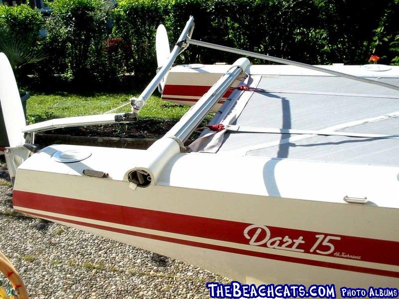

  • QuoteHow is that accomplished? Are the hulls pulled in against the beams by tightening the tramp? No bolts
    Correct. They utilize a clip/spring. You slide one end of the beam into the hull til it hits the retaining clip. When the other hull is slid onto the beam, the spring will pop the clip into place when beam is fully seated. If you look closely at the photo in your Dart 15 album, you can see the clip at the rear beam.
    http://www.thebeachcats.com/gallery2/main.php?g2_view=core.DownloadItem&g2_itemId=126183&g2_serialNumber=3
    Quote No doubt this was designed for the European market due to the limited storage spaces which required the catamaran to be taken apart as easily as possible!!!
    I agree. The Dart 15 assembly manual, ( I added it to Damons Dart 15 page), Page 1 talks about removing Cat from car roof.
    http://www.thebeachcats.c…ictures?g2_itemId=126206
    Page 4 of the manual explains how to assemble the frame via the springs/clips
