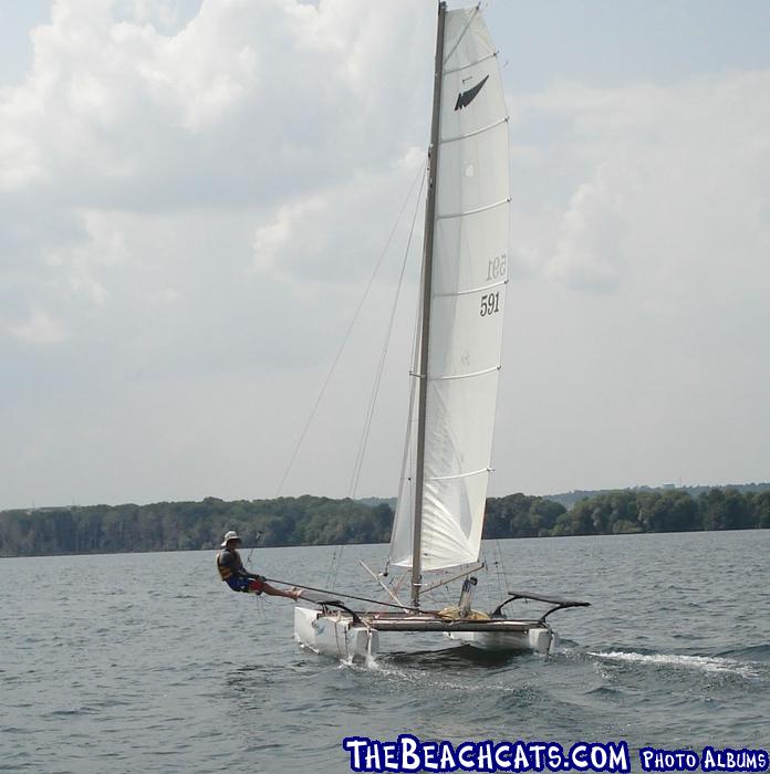

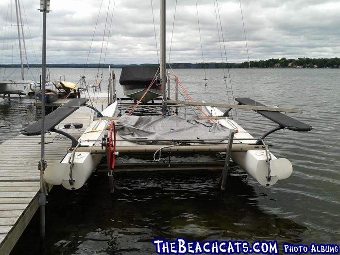

  • There are pros & cons.
    The good- girls love them, & if you use your imagination I'm sure you can figure out some other benefits. They make a very good backrest when sitting on the hull, or keep you up out of the spray when sailing in cool weather. They were pretty exciting to trap out from, you are a long ways up with a hull in the air.
    I'm only 175, & they give you added leverage to keep the boat down.
    The last photo is on the 20' Mystere, in only about 7-8mph breeze. It's a 10' beam,(13.5 with wings) & I'm just holding it down.
    The bad - $$$, hard to find, make the boat too wide to trailer,(my 20x10 Mystere 6XL is 13.5' wide with them), & it is something more to crash into when you flip. The spin sheets also tend to hang up on them when gybing the kite. This might not be an issue on all boats, mine were Hobie 21 wings, modified to fit the Mystere.
    You might need a longer hiking stick if you plan to trap off them.
    I never fell off them while trapped out, but I think it could hurt if you did.
    Mine wouldn't drag in the water, if you got it that far you were going over anyway.

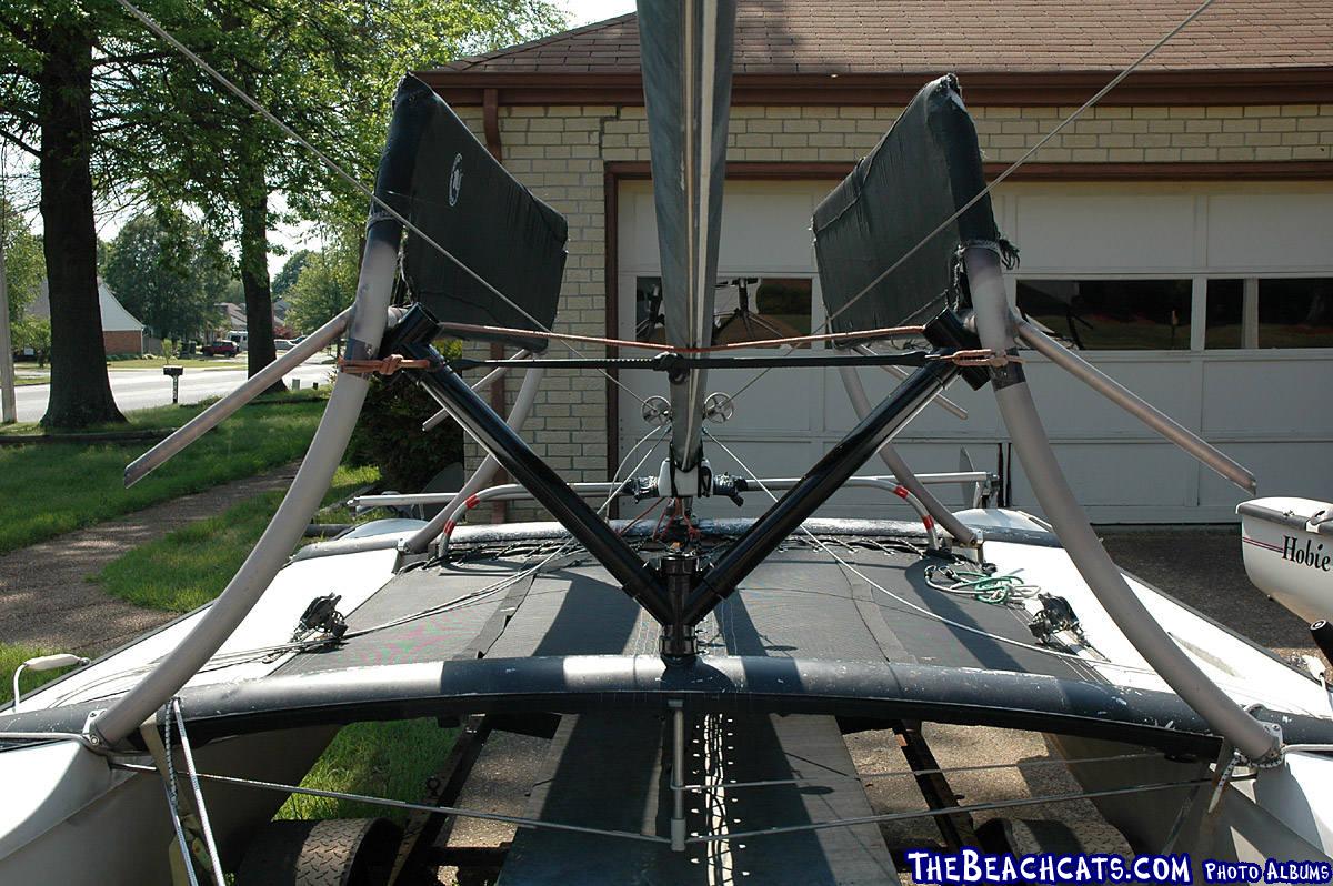

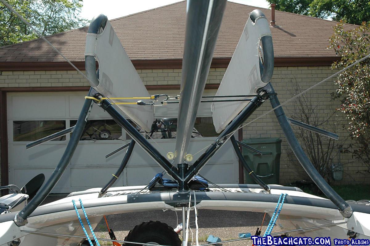

  • trailertrashjohnI am concerned with Edchris177 comment on not able to trailer with the wings. I thought I saw a picture somewhere that the wings unattach at some point and kind of swivel or move towards the center somehow, bringing them in from sticking out so far. Is this the way they work?
    Yes, here are pictures of the Magnum and SX wings when folded up. You have to have some kind of support to lock the wings in place for trailering so they don't flop around too much.
    Example home made support
    http://www.thebeachcats.c…pictures?g2_itemId=11711
    Magnum Wings
    http://www.thebeachcats.com/gallery2/main.php?g2_view=core.DownloadItem&g2_itemId=27755&g2_serialNumber=4
    SX Wings
    http://www.thebeachcats.com/gallery2/main.php?g2_view=core.DownloadItem&g2_itemId=27757&g2_serialNumber=4
  • The wings swivel up/inboard for trailering. No issue at all. They are kinda hard to find used, heck, its easiest to find a H18 magnum entire parts boat ( i paid $1200 with a nice trailer - hulls were toast ) and snatch the wings off of it then sell the H18 parts, I got $1000 back after a year of parting it out. Thats how i got my magnum wings. New wing tramps were about $250. To find a set, be prepared to drive a day or two each way, shipping is gonna be ridiculous.

  • QuoteI am concerned with Edchris177 comment on not able to trailer with the wings.
    Sorry for the mislead, I should have been more specific, and/or paid closer attention to what you are sailing.
    The wings on the Mystere (at least the lower) would need to be removed for trailering,(it's a tilt trailer). I never move the boat, so it wouldn't be an issue for me, & it is only 4 accessible bolts/wing, so it wouldn't be that bad, but I see it as extra set up time.
    A fellow on the island across form me sails an H17Sport, & his wings don't fold either.
    As you now know, the H18 wings can be unpinned & folded. I think there was a thread a while ago about using some quick pins to speed the process.
    They also make a good place to store gear if you camp, or do day trips to beaches. I had loops under the wing tramps to store the paddles.
    One final benefit, especially on the wide beamed boats. When you flip it, one wing will be underwater. That wing makes a bloody fine rail to stand on, allowing you to uncleat the jib, & gain access to your righting bag.

  • For casual sailing you will love an 18 w/wings over a 16. Tons more space in n additional n to more comfortable. The trailering pictures Damon posted are easy and secure ways to transport, I made ones similar and well worth the afternoon of building a support. I have looked into upgrading from my 18 magnum to a newer boat, but keep coming back to not wanting to give up the wings. As you get better at sailing, trapping off the wings is exciting and a real treat. The boat handles 3 people really well, but solo feels like a totally different boat. Sounds like you found a great deal, good luck finding wings.
