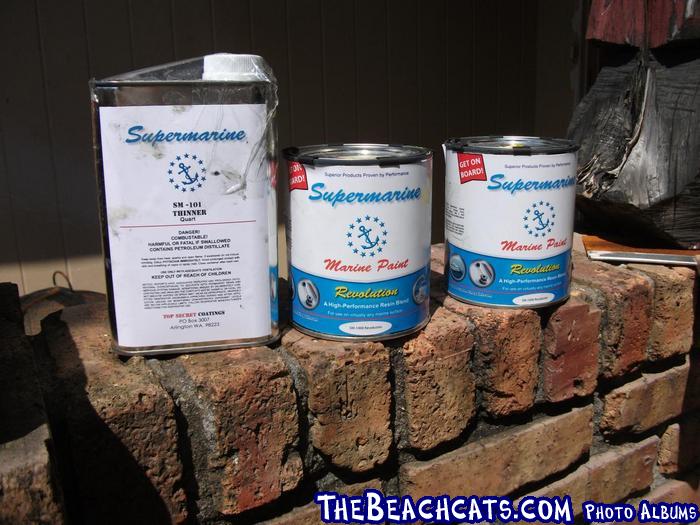

2 quarts did my boat(2 coats sprayed). the discoloration from under the graphics may not ever be right...the sun has bleached out the exposed gel coat... i couldn't get mine to look good. no need to sand off the traction on the deck lids, make sure to wash the boat real good and scrub the lids with the green 3m scotch brite pads. the rest of the hulls sand again with 220 grit to scuff for paint(1500 grit is to slick for paint to stick to it). spraying will get better results(unless you run or sag it bad!). i used this paint high gloss finish, no primer required, turned out great!check out my album in the members albums titled prindle 16 hull paint and repair, now is a good time to build up some glass on your keels!

Link to Paint Album http://www.thebeachcats.c…pictures&g2_itemId=72641
