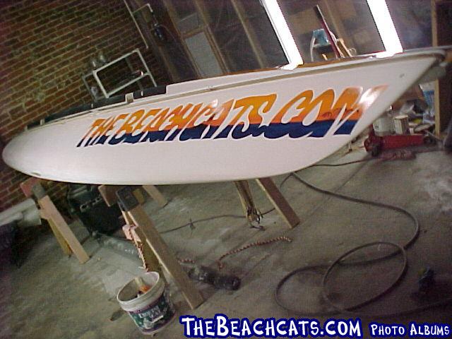

  • On my previous 1981 H18 I had the graphics painted by a friend that used an airbrush and marine paint. They looked and lasted great, but it was a big project, he did a bottom job at the same time.
    http://www.thebeachcats.com/gallery2/main.php?g2_view=core.DownloadItem&g2_itemId=27660
  • Did he spray anything over when done to seal or protect it or just using a marine paint enough? How well has it maintained since then?
    edited by: Quarath, Apr 23, 2009 - 11:08 AM
  • I don't think there was any clear coat. It has held up perfectly, and that boat (I've since upgraded to a newer h18) was sailed a lot in a muddy lake and was cleaned regularly with Oxylic Acid, it was polished, and even wet sanded once. The paint is probably tougher than the gel coat, so nothing has bothered it.
    The graphics have been on that boat for about 7 years now.

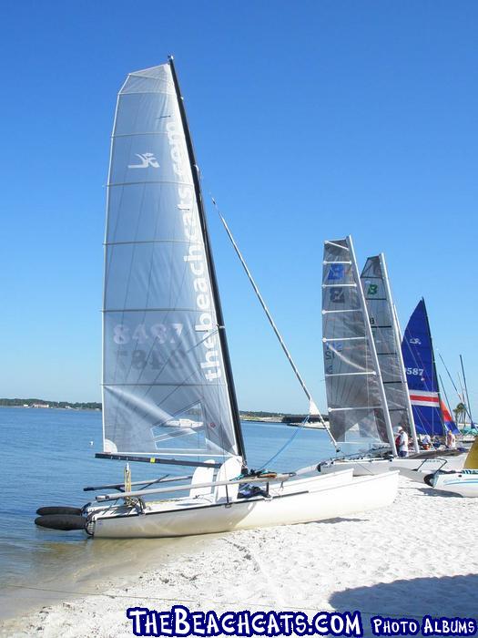

  • Hy current H18 is nearly invisible, the color is draining from our regattas.
    http://www.thebeachcats.com/gallery2/main.php?g2_view=core.DownloadItem&g2_itemId=31771
  • Can you do the Beachcats.com text on the sail in a brighter color least or is the material used only in White or black.
  • Yeah, the letters should have been in black instead of white, (or blue/red) I didn't realize how little contrast there would be. If the sail material had been as dark as the boats in the background the white would have worked better.
