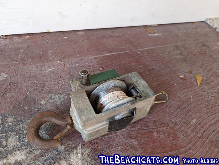

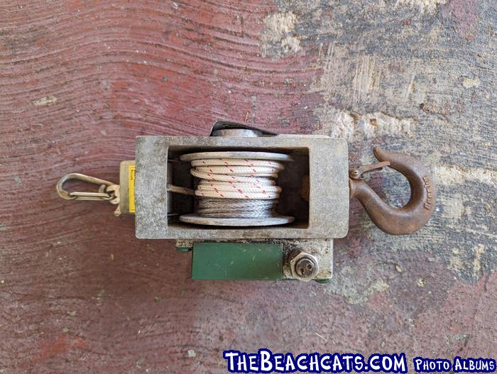

  • I have a worm drive come-along (a very rare find) that I converted to use a battery drill and 3mm dyneema. Spools up 100ft of line. I hook to the mast base, run the drill with one hand and attempt to do pitch control with the other. The free end of the line is to a danforth in the sand. Handy in a pinch but not a speedy way to move a boat.

  • My battery drill winch. The black tape is to cover the greased bronze bearing.
