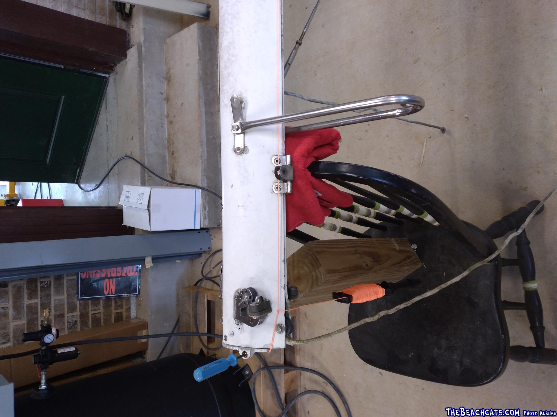

  • Yeah. I don't have a lower cleat on the fore-spar or on the mast. Do I need to install one? Images below to assist
    https://www.thebeachcats.…ictures?g2_itemId=136342
    https://www.thebeachcats.…ictures?g2_itemId=136346

    This is where I'm stuck as well. The eye strap is on the front of the mast so I assumed it was used for the job in some capacity. I don't think I've ever seen a downhaul connect and then wrap 180 around the mast - is that a thing?
    Here is a better view of that eye strap opposite the downhaul cleats on the front
    https://www.thebeachcats.…ictures?g2_itemId=136349

    much more likely this is where you attach a bungee as a jib sheet jam preventer (they get caught under the mast base when you tack).
    edit: i think mystere's also tied off the jib to this eyestrap in the past too - i have seen that on most mystere masts (many) and it is where i "park" my jib halyard when stowed (jib halyard tied to the jib sailhead D-shackle and secured to this eyestrap for tow/stow
