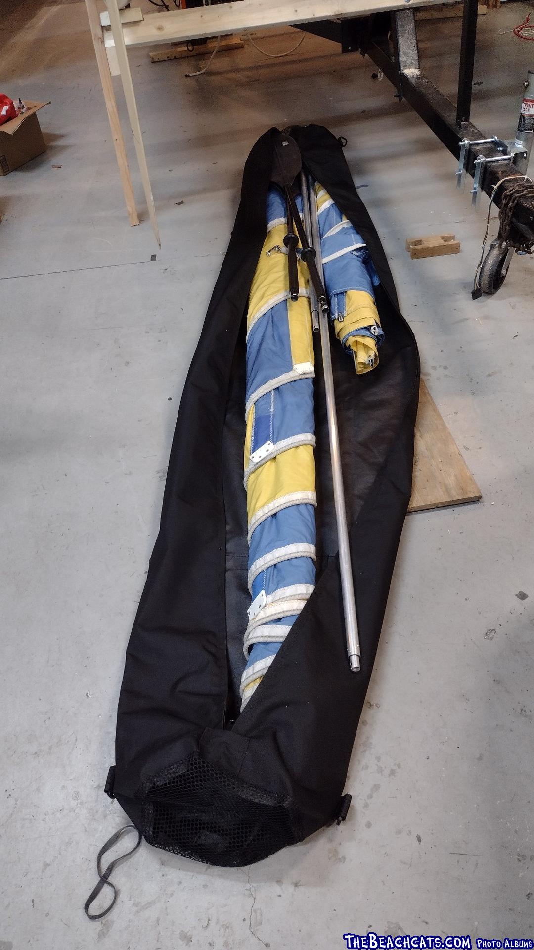

  • So, I made a sail bag with a full length zipper and mesh ends.
    https://www.thebeachcats.com/gallery2/main.php?g2_view=core.DownloadItem&g2_itemId=136264&g2_serialNumber=3

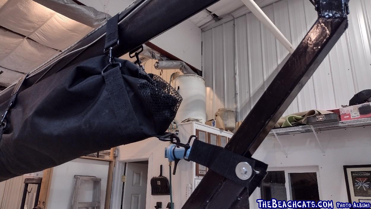

    Around the bottom of the bag, I sewed on a total of 6 straps with D rings on them. Then I made 6 straps with snap clips on either side to hang it on the mast. Also I put a couple of D rings on the bottom of each end. The picture below shows the front of the bag. I bolted on a fixed strap that I clip the bag to.
    https://www.thebeachcats.com/gallery2/main.php?g2_view=core.DownloadItem&g2_itemId=136260&g2_serialNumber=3

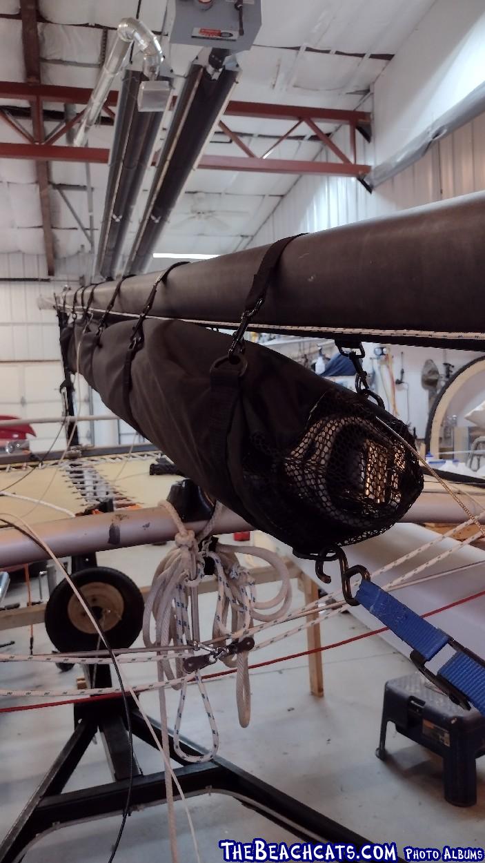

    Here is the back, with a blue cam strap pulling back to the aft mast support. Not sure if this will be the final configuration or not. The back can still flop around a bit, whereas the short leash of the front fixed strap keeps it stable.
    https://www.thebeachcats.com/gallery2/main.php?g2_view=core.DownloadItem&g2_itemId=136259&g2_serialNumber=3

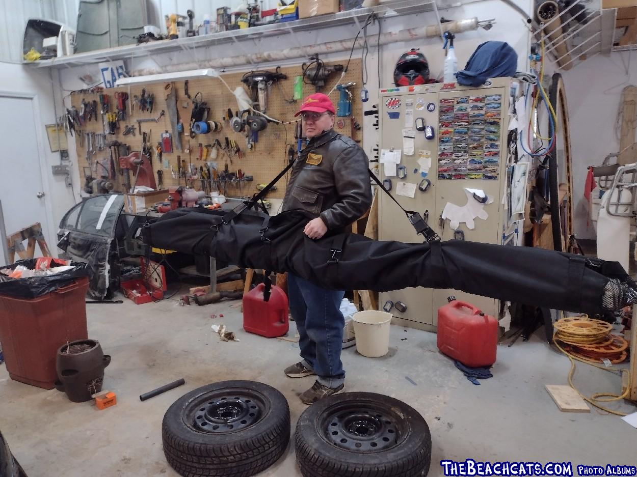

    Two of the straps that hold the bag on the mast are reinforced with a little hovercraft skirt material. This lets me slip then through a shoulder strap without the webbing bunching up.
    https://www.thebeachcats.com/gallery2/main.php?g2_view=core.DownloadItem&g2_itemId=136252&g2_serialNumber=3
