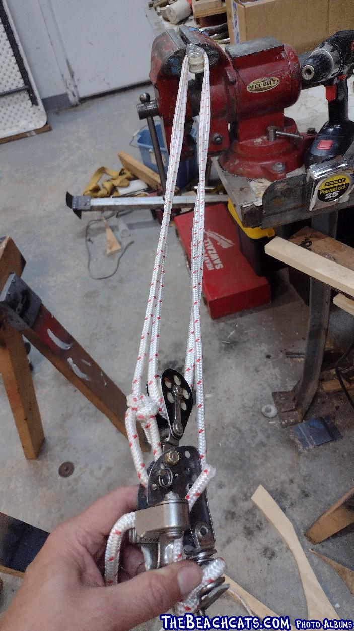

  • I put together a block for the righting bag. Used an old H16 jib traveler, a double sheave, and a single sheave that I had in my box 'o junk.
    https://www.thebeachcats.com/gallery2/main.php?g2_view=core.DownloadItem&g2_itemId=135787&g2_serialNumber=3
    I need to test the garden bag I bought.
