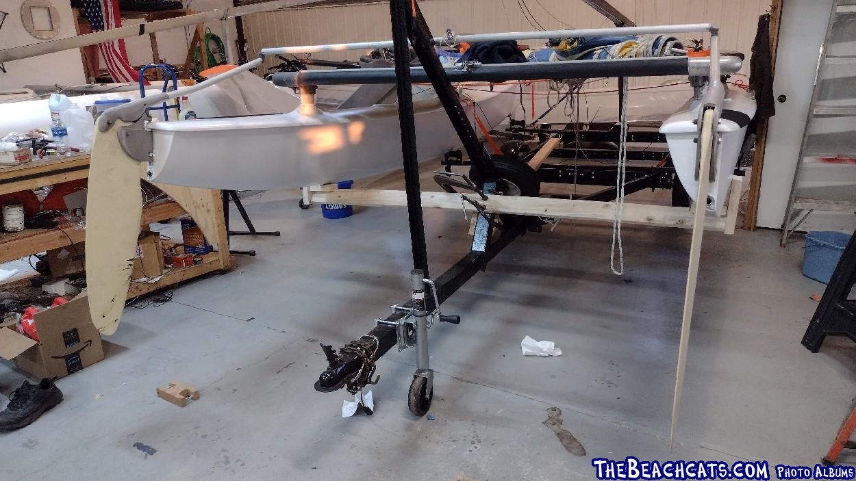

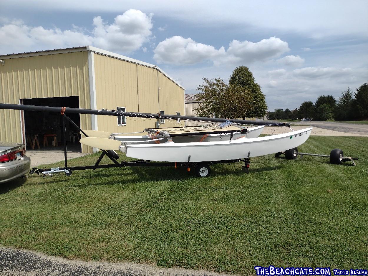

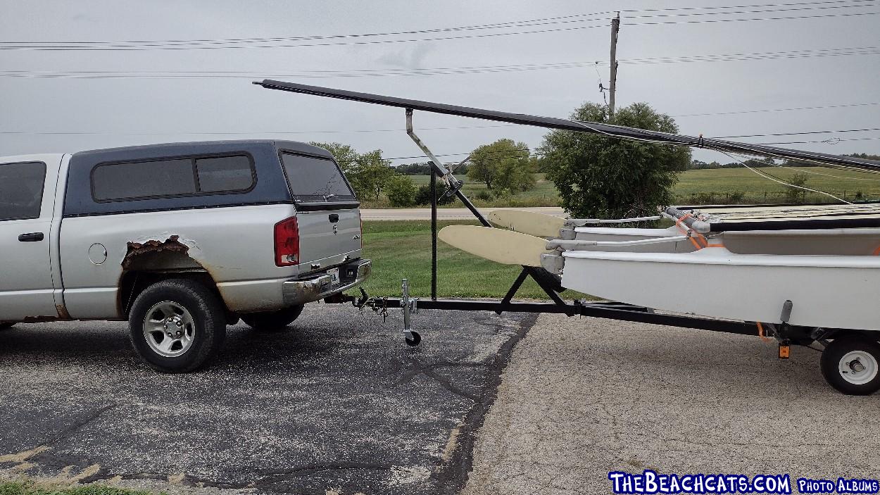

So on my lunch break today I walked over and put the H16 on backwards:
No drama, and I still have positive tongue weight. Should I detect any instability on my test run I'll move the axle back one set of holes.

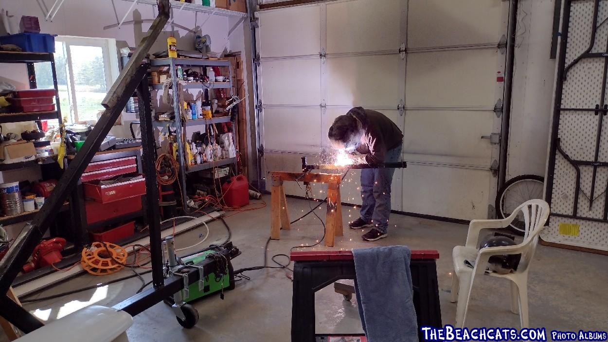

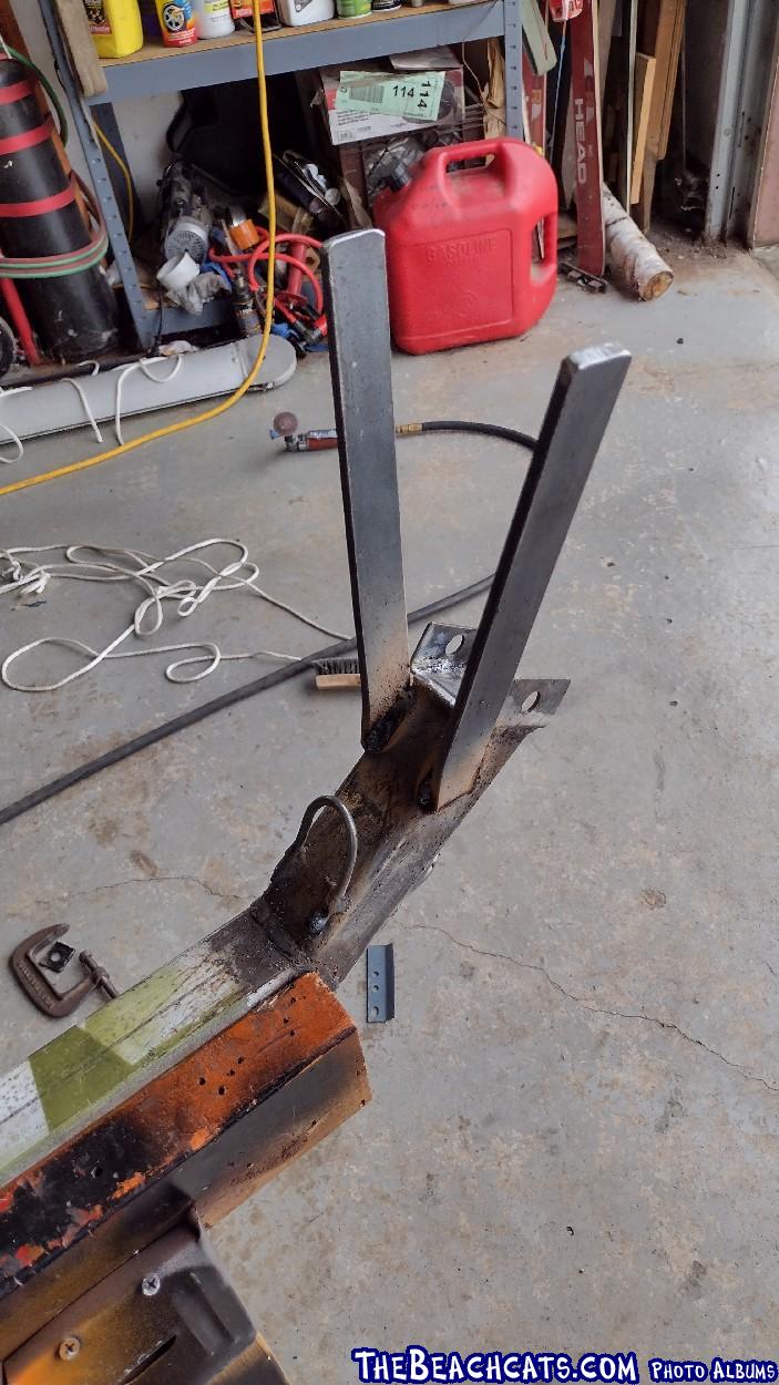

My nifty aft mast support is too short. I'm going to lengthen it, and also redo the front support. I have these objectives for mast support modifications:
1) Make the mast high enough that I can use my pickup to tow the boat. I have a cap on the bed and it is sort of tall.
2) Increase the angle of the mast a little bit, so when I start the step I'm a little higher.
3) Ensure the mast is balanced as I'm sliding it to pin the stepping hinge. It is pretty close to the middle of the mast. I'd like the mast to be balanced that it would rest on the tramp rather than on the car if I let go.
4) Add a couple of guides on the sides of the mast support, so it can't easily fall out of the V or rotate.
Also, the rudders are nicely lined up with the claptrap that is welded/bolted together for the forward mast support. I'm thinking I can make a removable bracket that I can bungee the rudders to for trailering.

I’d be a little concerned about how much of the boat is sticking out past the back of the trailer and visibility of the tail lights. I believe there are usually state laws that define how far beyond the tail lights objects attached to the vehicle are allowed to extend. Probably need to place some red flags at the very least.
sm -
- Registered: May 03, 2006
- Last visit: Jun 04, 2025
- Posts: 278
Rules vary everywhere, but usually allow 3'-6' overhang beyond the lights before you have to add a flag (daytime) or a light (night) on the longest bit. At the moment the SC19 mast+rudders are overhanging 6.5'. The Mystere isn't here so I can't check, but it's similar and I've never been stopped anywhere over it, and I've never bothered with a flag or anything else.
