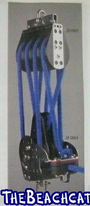

  • This is a picture of a low profile 7:1. Click on the pic to enlarge.

  • pknapp66This is a picture of a low profile 7:1. Click on the pic to enlarge.
    https://www.thebeachcats.…ictures?g2_itemId=130420Edited by pknapp66 on Jul 20, 2021 - 07:04 AM.
    The irony is that mine does not have the anchor loop below the top block. It only has it on the bottom.

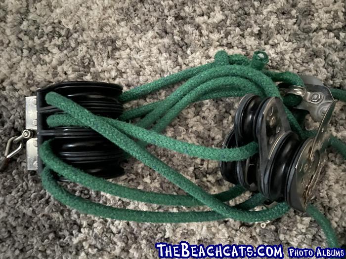

  • https://www.thebeachcats.com/gallery2/main.php?g2_view=core.DownloadItem&g2_itemId=135292&g2_serialNumber=4
    Here is my main block with the original sheet, and I don't believe it is correct. I want to reeve the new sheet and cannot find a diagram anywhere.

  • UPDATE:
    If anyone else performs an exhaustive search for this elusive, rare and undocumented 8:1 Mainsail block system, here is the correct method.
    https://www.thebeachcats.com/gallery2/main.php?g2_view=core.DownloadItem&g2_itemId=135302&g2_serialNumber=3

  • Picture makes all the difference - yep, your system is designed for 8:1, not 7:1.
