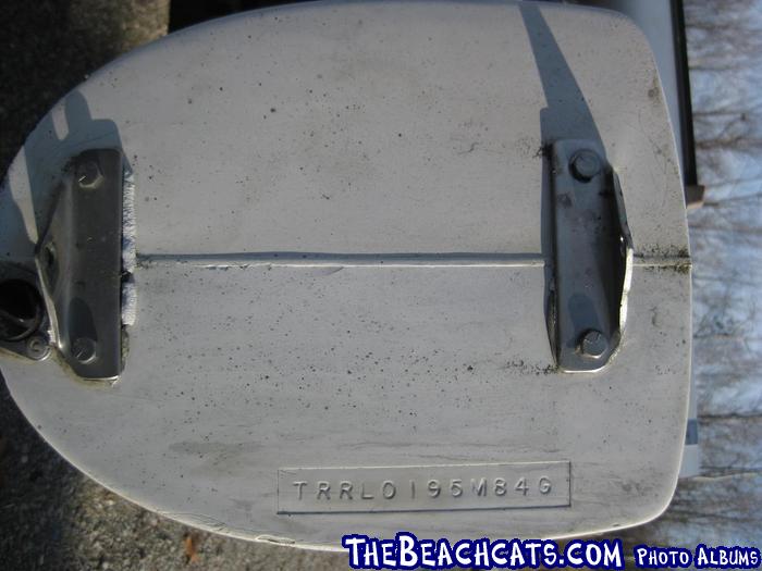

    Here is the HIN from my ‘84 N5.7
    https://www.thebeachcats.com/gallery2/main.php?g2_view=core.DownloadItem&g2_itemId=135187&g2_serialNumber=4&g2_GALLERYSID=63d4448ef3689d00af33ef0cd72c490a

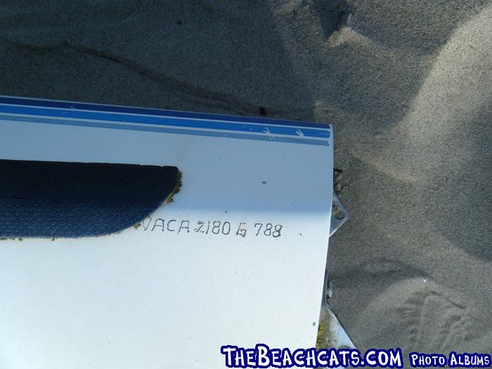

    Here is how the ‘88 N5.0 HIN looks
    https://www.thebeachcats.com/gallery2/main.php?g2_view=core.DownloadItem&g2_itemId=103263&g2_serialNumber=4
